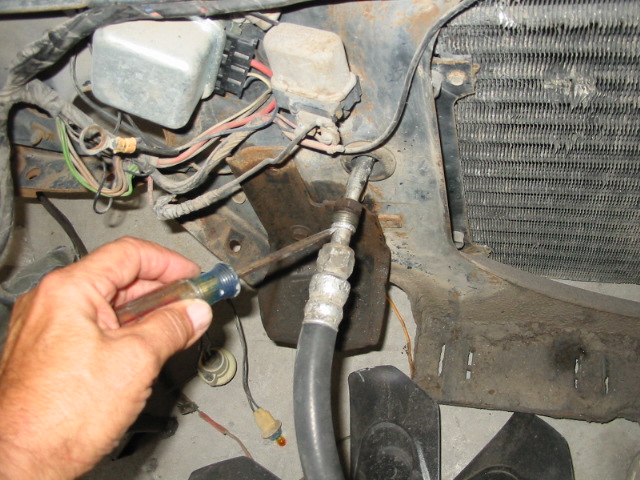

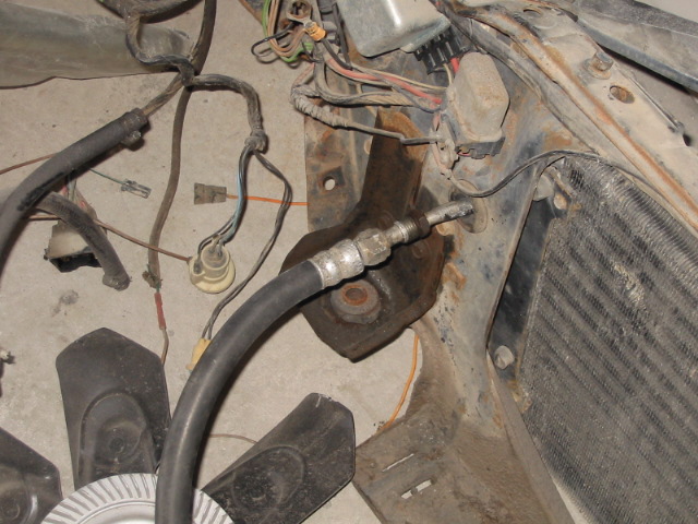

With the Chevelle close to actually doing the painting I am wanting to clean up the radiator support. Can't get the pictured A/C line to come apart where the screwdriver is pointing. Have the threaded nut loose and pulled back, problem is the line won't seperate at the connection. Have tried a gentle twisting and tugging motion with no luck. Anyone had this problem with their A/C lines before? Maybe PB Rust Blaster and heat? Not a torch, maybe a blow dryer on the low or high setting? Don't want to melt the line, LOL Any ideas ??

That part of the tube is a formed little collar with part of the tube going in. Put some kind of penetrating oil on there, let it sit and tap with small hammer.......should come out.

Ken, tried using PB Rust Blaster on it, hand tightened the female portion to the male portion of the threaded nut/coupler. Tapped on it with a small 8 oz. ball peen backed up with a 1'' square stock solid bar. No luck at all, can't fit get a thin knife blade between the flanges to start a separation going. Am I hosed on this, alternatives? Need to get this separated to clean up the radiator support for paint. Will try using an actual heat gun next time, ran out of time today.

Finally was able to seperate the A/C lines, don't hink it will help me much tho. Inside of the lines look pretty rusty/crusty/nasty. Not sure they will clean up enough to use after a flush. Also found out I am missing a LH lower condenser to radiator support bracket. Always something unexpected, huh?

Sounds like a log of condensation got into them is why they rusted
