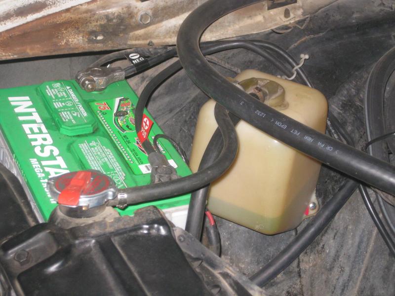

1970 Skylark Washer Bottle with the lid from a 1985 Riviera overflow bottle. Thes lids fit most GM washer bottles and makes it easy to convert them to an overflow bottle. This on fits nicely on the passenger inner fender.
