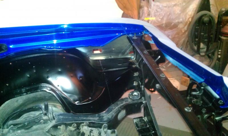

I got the hood jamb area sprayed. Now I got to put the front end back together. Go to one of the doors. I got a couple areas to touch up once it dries but decent overall.

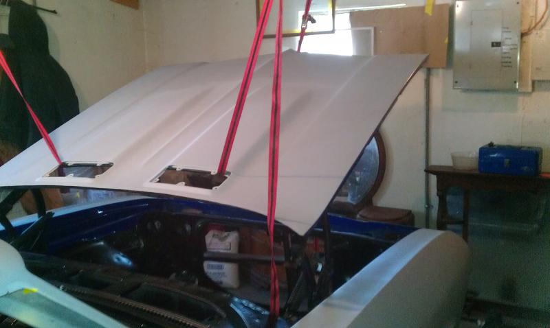

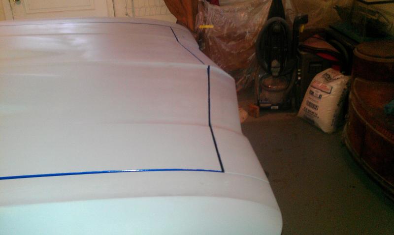

Okay talked me into pics. I wasn't sure if I was boring anyone. It a big deal to me because it my baby, but you know how parents and baby pics are.
Hillbilly Bob method of puttimg the hood on. LOL actually it was hung there to make it easier to paint the edge. Right at eye level. And right where I was working. Less dragging the air hose around the less dust gets stirred up reckon.
Nose piece looks fine but being a body guy eyes are not where it is at, you see much more with your hands. Running my hand over the hood to nose piece changed. don't feel quite right. 15 minutes board sanding will knock off the edge. Tightening all the bolts and inner fenders down changes the shape a hair. It a delicate balance. Don't want to do the bodywork after the jambs are painted or they get messed up. So do it and paint then assemble and block it again.

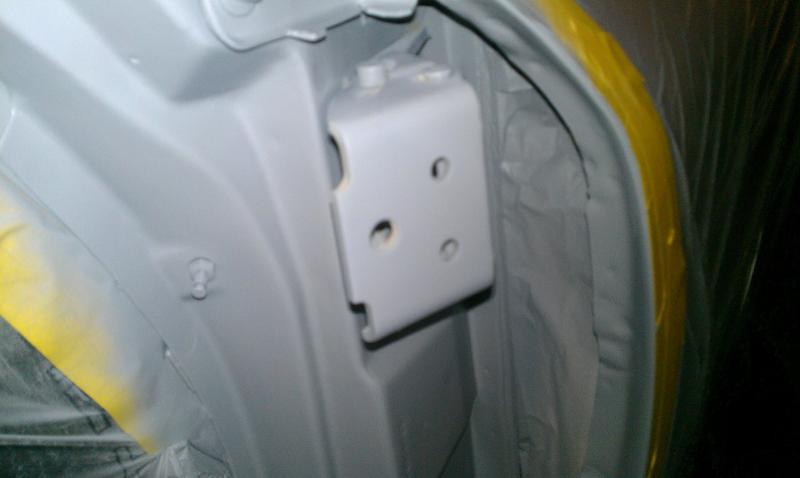

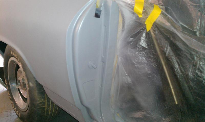

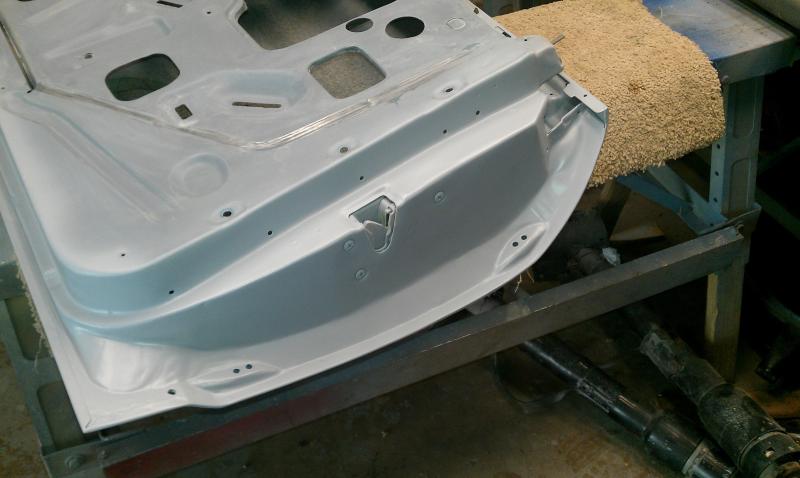

Inside of the door ready for primer and the door jamb itself is close. I expect to have it taped and ready today. I got to cover the dash and front section real well. Like i mentioned before I out of hardener for clear and almost no clear. Time for a supply run after we get paid monday. re-stock on some things.
I had enough but doing other things I used the clear up slowly over time. Fixed rust on the wife's Durbango. My dad put a nice scratch in his formula firebird. I had to fix that and paint the side. Well not had to but it is dad and well I kind of owe him for putting up with me growing up LOL. You know life happens stuff.
I aint going crazy it is a door jamb but I been doing some bodywork on the parts you see with the door open. Smoothing out the factory wrinkles in the metal from the stamping process. Charlie Anal made a guest appearance my buddy said. He just rolls his eyes back in his head. He is a retired factory line worker from GM making camaroes and firebirds. So I got some inside tips on what they were doing.
I slept in today but i been hitting it real early lately so I can get some hours in before actual work starts.
chevymaher 04-30-2014 02:06 PM
Well I got it done and sqeezed priming in between work and my household taxi runs.
I got sanding and then I got to go to the paint supply. I need hot rod black, clear, some more primer, and tape since I use 10 miles of it every time I turn around. I got plastic. A whole new roll. I painted 3 normal cars. Just mask not every nook and cranny, normal detail. And did everything to this chevelle and there some left. So I doubt I will need more no matter how much I waste.
I got new door hardware so I will put the new in when after it is painted. Door striker will come off for paint and get wire wheeled clean. But I want the primer as a guide because the door is perfect adjustment now. I will use the ring as a guide to put it on. Door latch will be a pain to clean it will be mask for paint to. See the bondo in the door jamb? for those little pesky stamping wrinkles.
