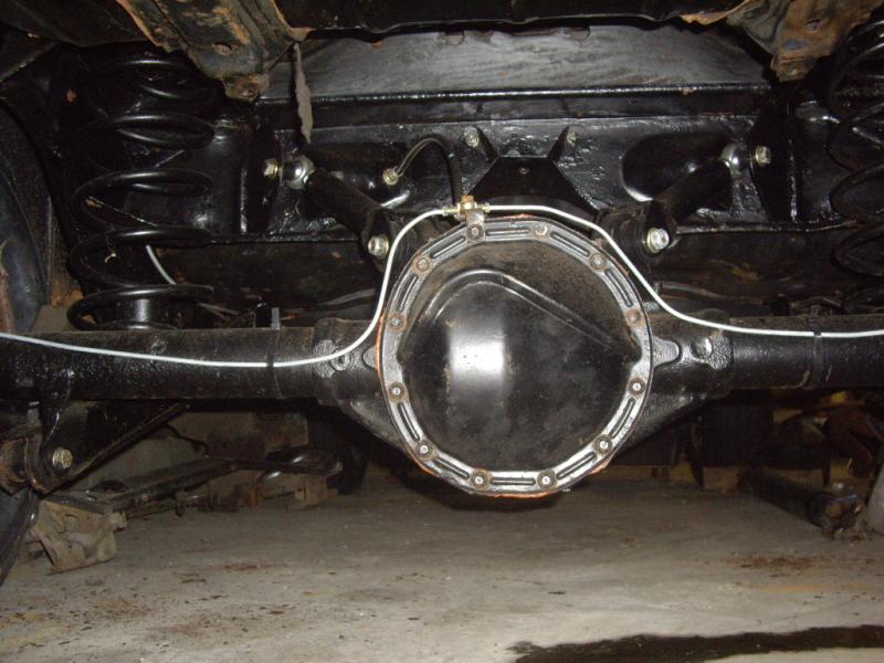

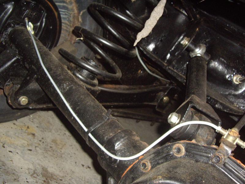

TD72chevelle 09-05-2012 08:20 PM
Speaking of the rear end, i have a couple pictures of it and as far as i can tell it is a 12bolt and i do believe the control arms are boxed as well. Let me know if i am mistaken or not.
http://chevelleforum.org/picture.php...pictureid=2962
http://chevelleforum.org/picture.php...pictureid=2963
carpoor 09-06-2012 10:30 AM
Yup, 12 bolt rear. Looks like aftermarket upper control arms.
TD72chevelle 09-06-2012 11:02 AM
thanks, i didnt think they were stock ones either. now i have to find out what gears the guy put in the rear end to see if they need to be swapped and figure out where he was heading with the resto
TD72chevelle 09-06-2012 11:27 AM
also, do you think that the control arms on there now would work if i put 400hp to the rear end or should i up grade them too?
carpoor 09-06-2012 12:08 PM
Pop the cover and count the teeth on the ring gear and pinion gear. Plus you can check the wear pattern, etc. at the same time. Those uppers are geared towards racing, and will increase ride harshness and noise. The stock upper arms are plenty. They used the same stamped arms on LS6 Chevelles. Those cars were heavy and rated @ 450 HP/500 TQ. My father and his older brother bought & raced one in 1970-1972. It ran high 11's in stock class. (slicks, gear swap, open headers) There are a few stealth ways to reinforce them if you feel it is needed. (stock upper arms)Usually a good set of polyurethane bushings are all that is needed though.
