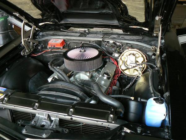

classic 07-11-2011 03:34 PM
1 Attachment(s)
Mine is mounted above the heater box...
