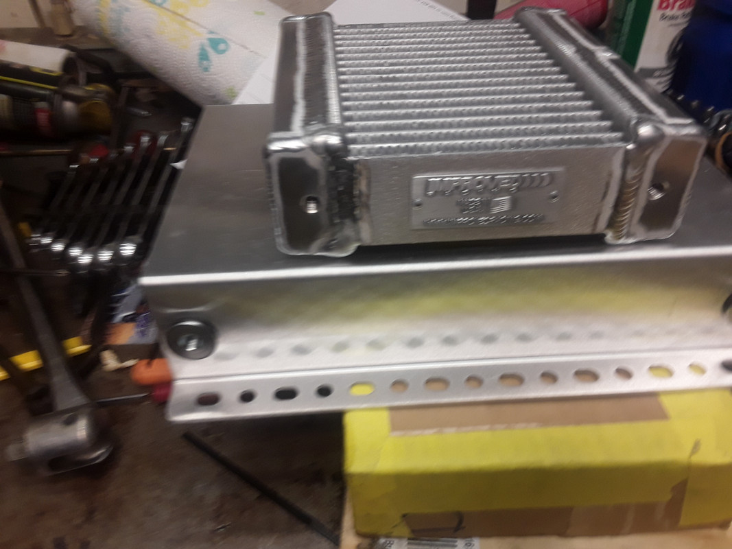

All my parts are here now.
This is the cooler and i got to cut the shroud down to fit it.

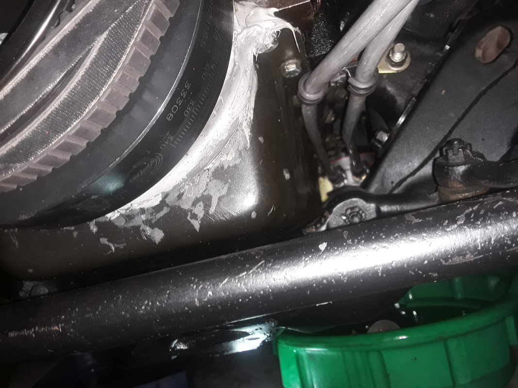

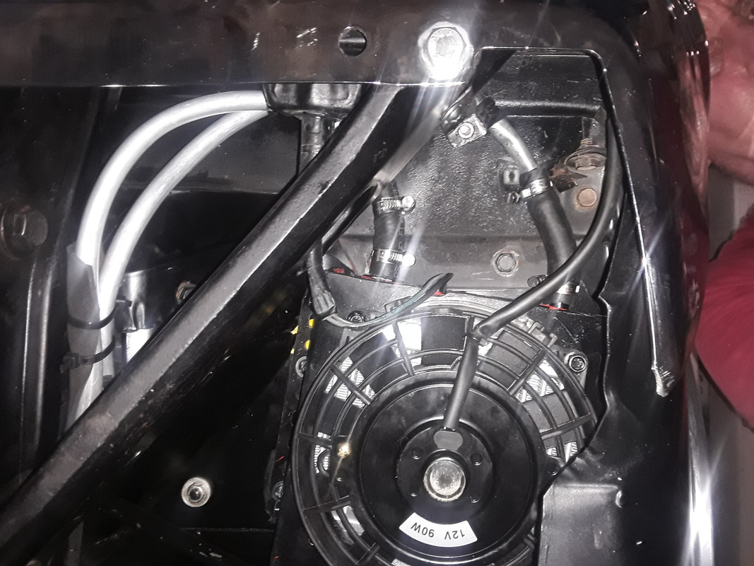

chevymaher 06-19-2023 05:28 PM
I still got a hot and a ground to run for the fan. But I started it and no leaks and got oil pressure.
https://i.postimg.cc/hvYPsGbF/20230618-144342.jpg
https://i.postimg.cc/W3W2p4yD/20230619-143941.jpg
chevymaher 06-21-2023 01:47 PM
Okay it is completely done tools away. And it is clean again. It was fingerprint heaven.
