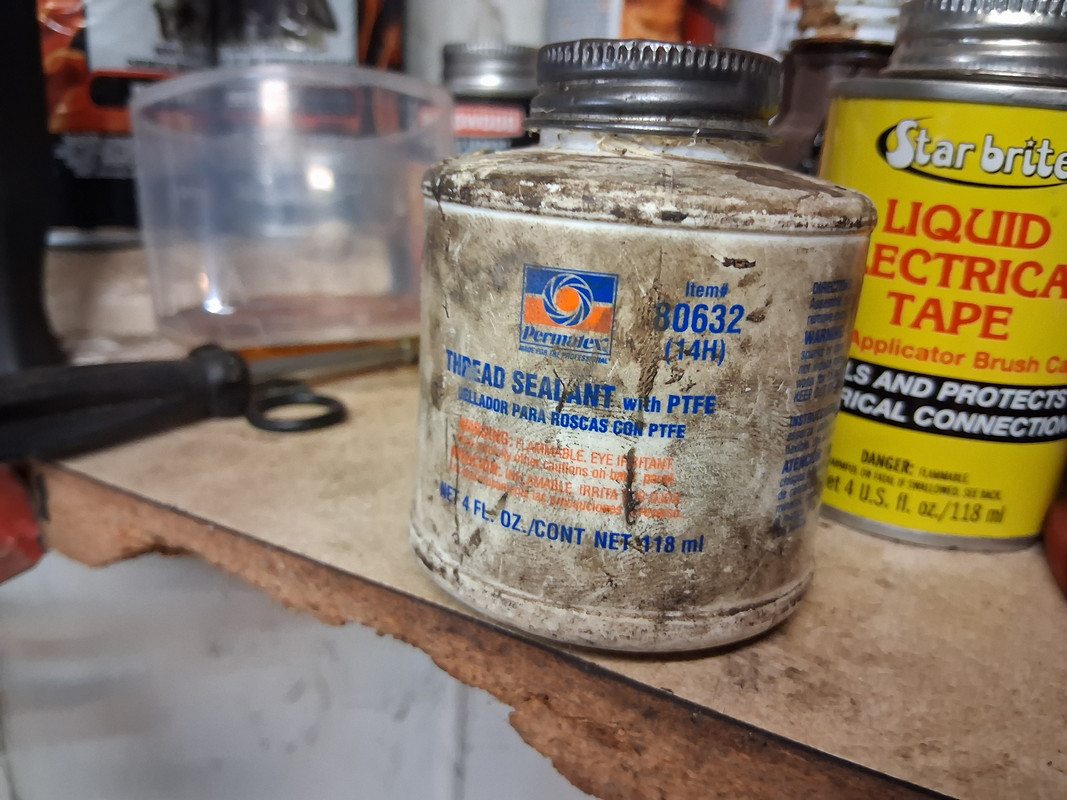

I was using thread sealer on my brodix heads. Brodix said to use this. https://i.postimg.cc/BQ40X69R/thread-sealer.jpg
mattimuss 05-31-2025 01:05 PM
Hello chevymaher,
Thanks for the reply an info. I also have that type of Permatex on hand and was planning to use it.
To make sure I understand, you put the Permatex on ALL of the rocker arm studs and didn't worry about Loctite?
This is my first time dealing with rocker arm studs and I do not want to have to do this again.
v/r,
Matt
chevymaher 06-02-2025 05:21 AM
Any going into the water jacket I would use it. Just make sure they torqued down well.
