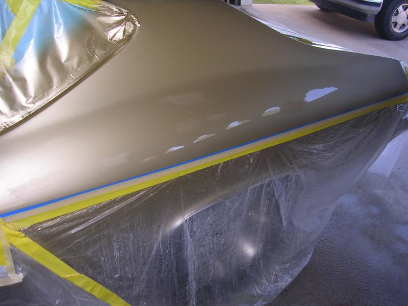

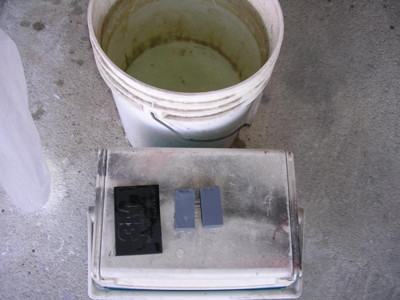

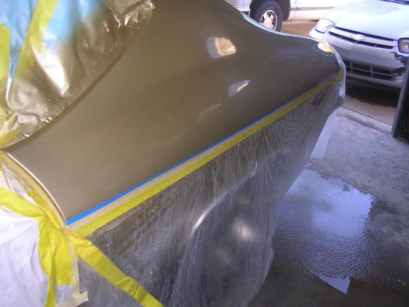

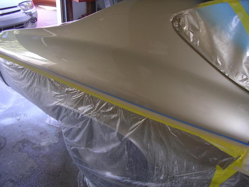

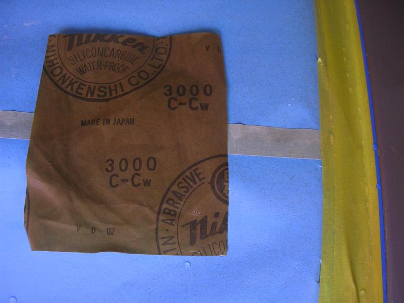

So I sprayed the car last nite and today I wetsanded the minor dirt nubs in the clear with a 2000 grit block thats available from Meguires...Now I do "just the nibs cause I want to leave the "orange peel".if I sand flat it wont match the rest of the car. After this I sand all the clear with 3000 grit under a foam pad and then polish with a machine.
