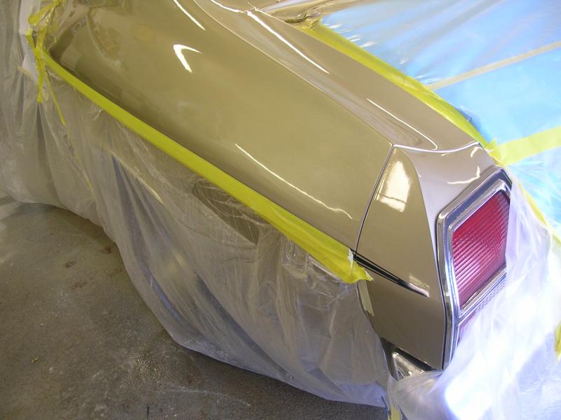

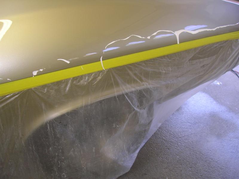

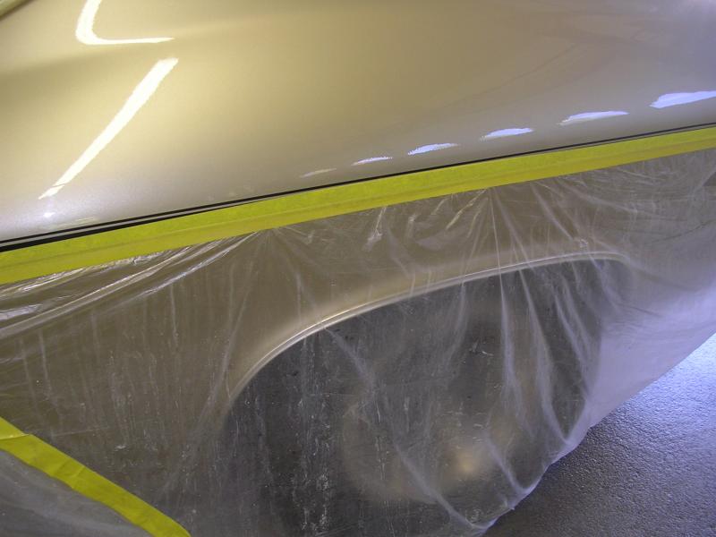

After I've polished everything with hardcut once I have the stripe to deal with before final finishing..When I pull the fineline tape up there is a "sharp" line along it that must be knocked down. So I pull just the fineline and replace it with 1.5 inch and lay it about 1/16 of an inch below the existing tapeline and hardcut this sharp edge off whith the polishing wheel,doing this makes it less noticable that you used the stripe as a border
After that I expose the 1/4 extensions and use a fine compound on all surfaces and then polish by hand.

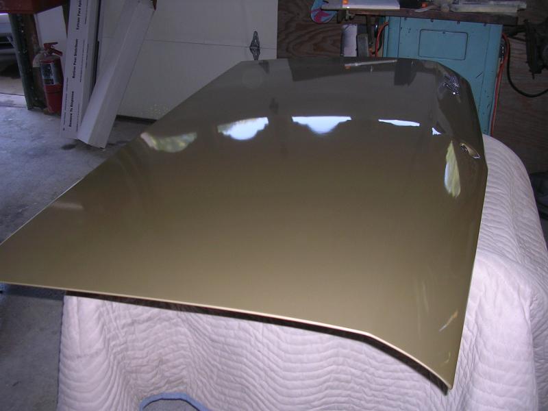

Since I didn't paint the decklid I hardcut that with compound and final finished it also so it would hopefully shine as nice as the top[s of the rear !/4 panels and it did turn out well......
