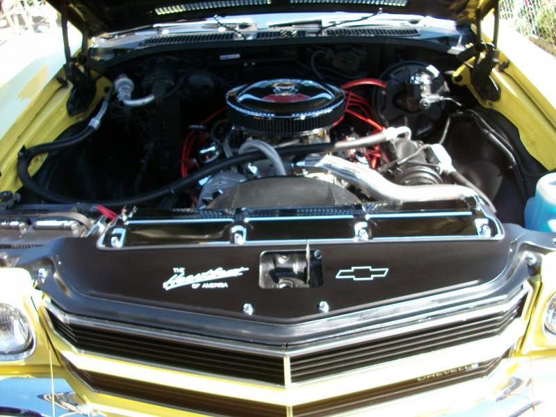

Another thing you can do is put a panel on your radiator support to block the open space and force the air through the radiator. www.undercoverinnovations.com is where I got mine.
