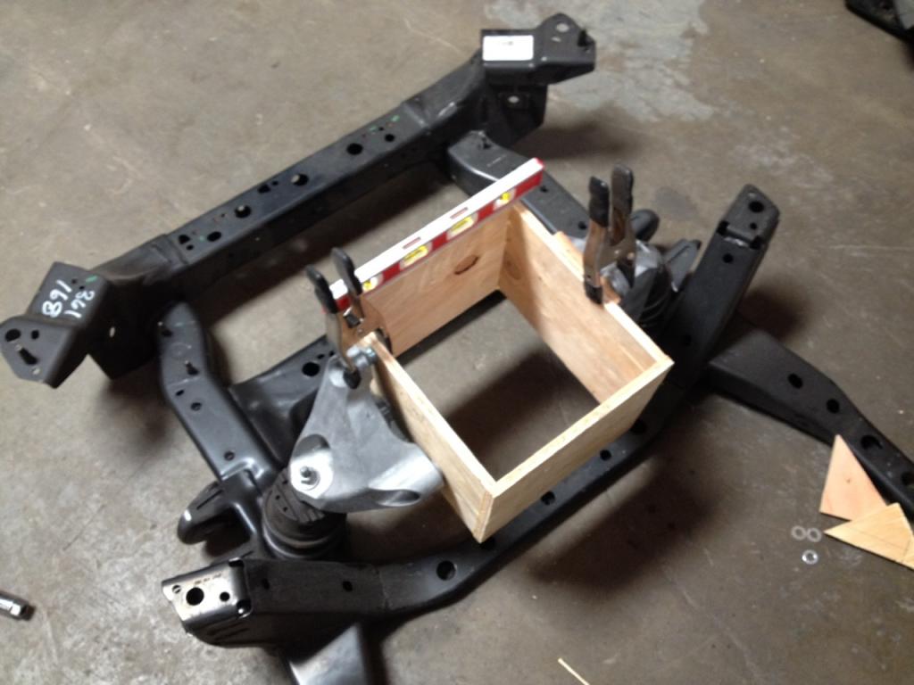

As it turned out, the sides of the LFX V6 are perfectly parallel to one another. So I built a wood box the same width to start with the motor mount fabrication. Way easier than swinging the engine in and out a hundred times.
This pic is of the engine box mounted to the Camaro sub frame with the Camaro mounts. This way I knew it was correct.

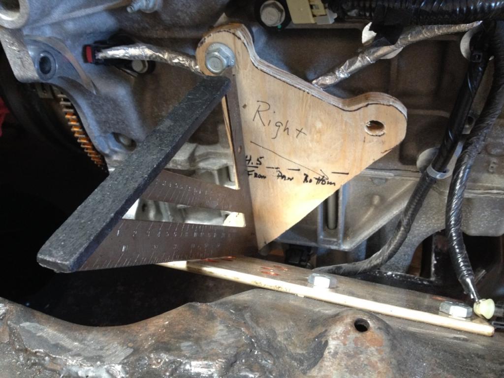

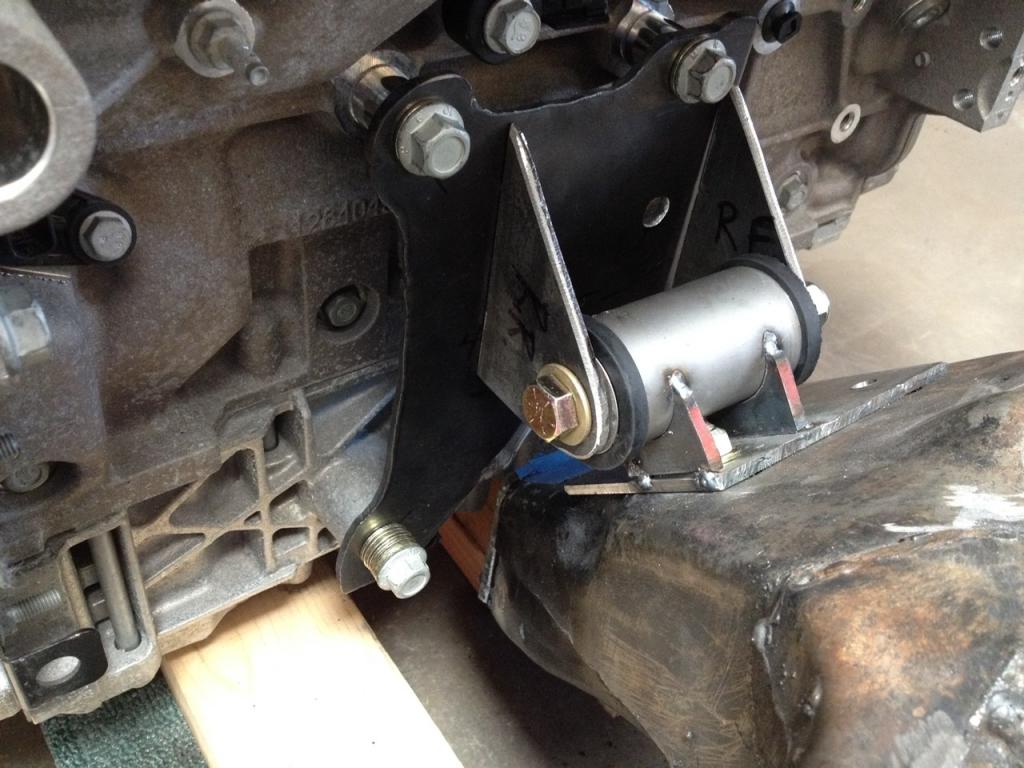

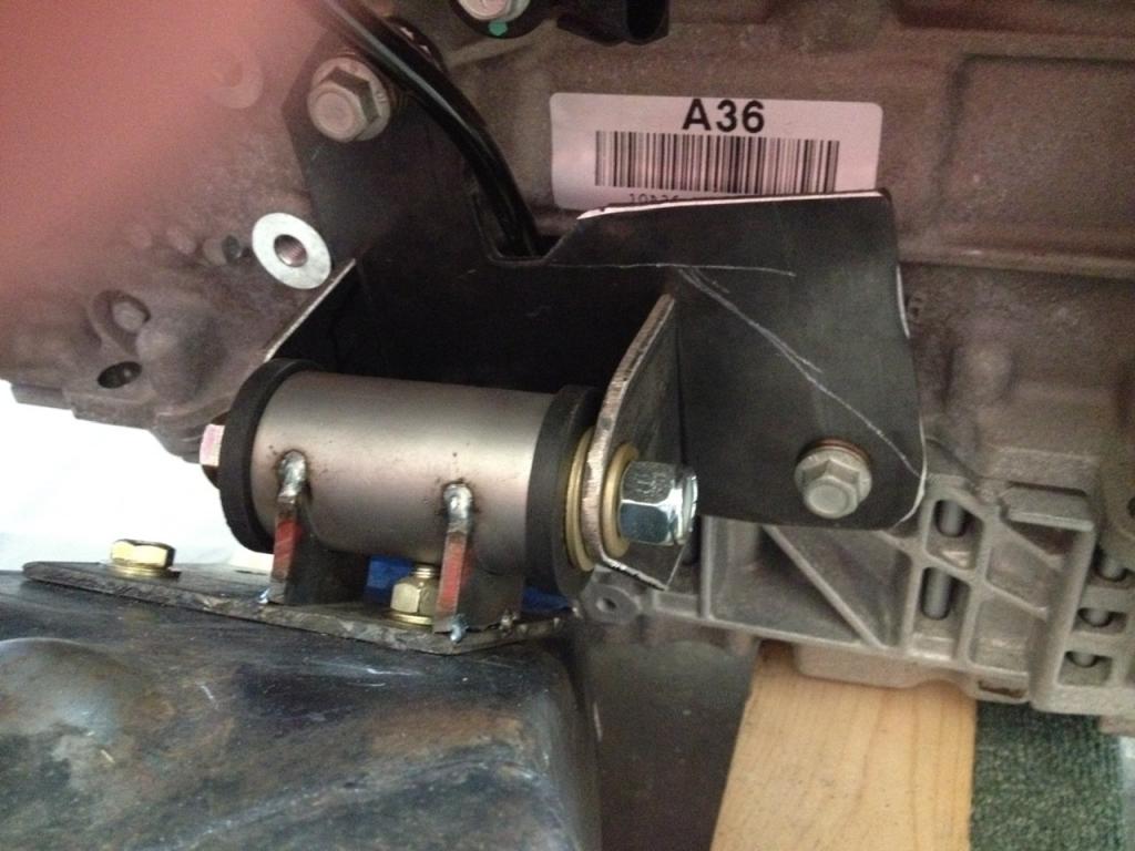

I built the engine side plates out of wood and then transferred it to steel.
I tacked them together than pulled them for finish welding.
