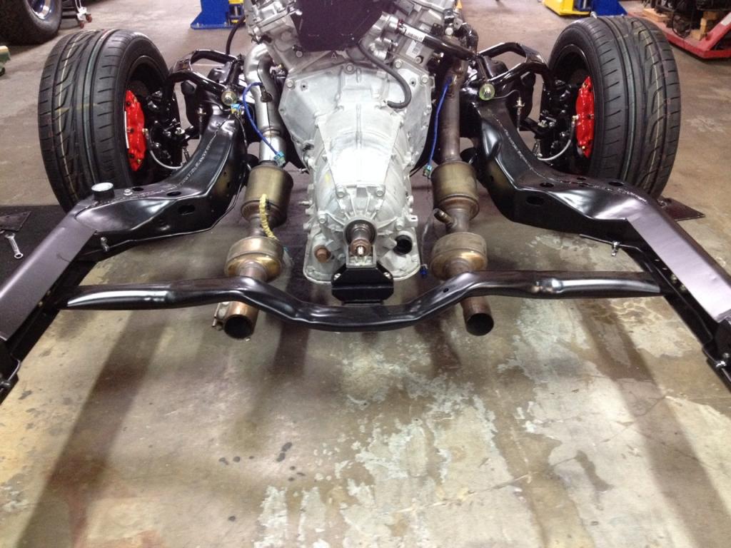

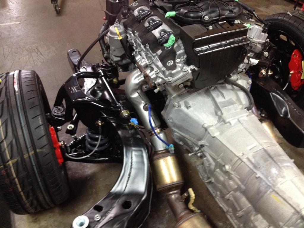

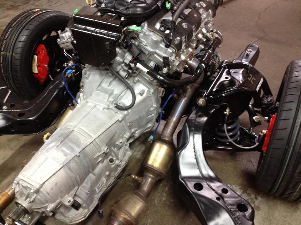

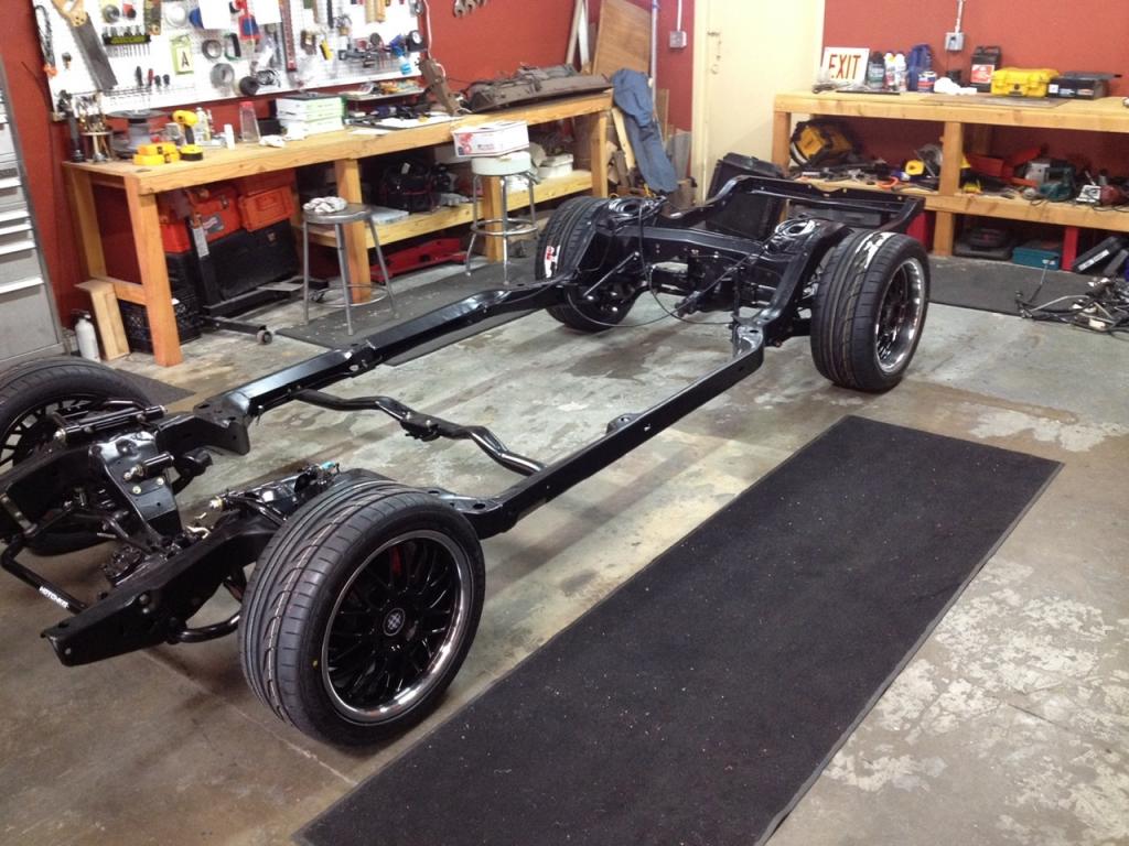

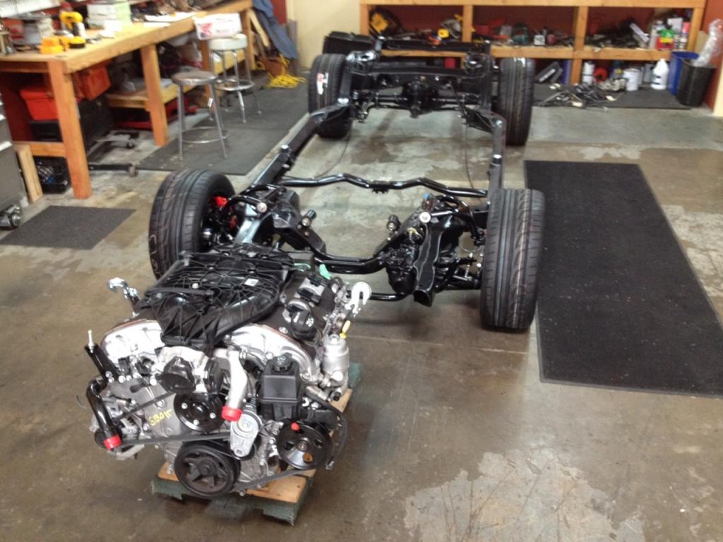

Having the body off made it easy to set the engine/trans. I was also able to run the brake and fuel lines. Also added the 17x8 and 18x9.5 rims and tires.
The exhaust down pipes (Manifolds are built in to the heads) from the Camaro lined up perfect with the humps in the stock Chevelle crossmember. Pure luck.
