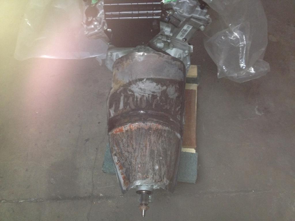

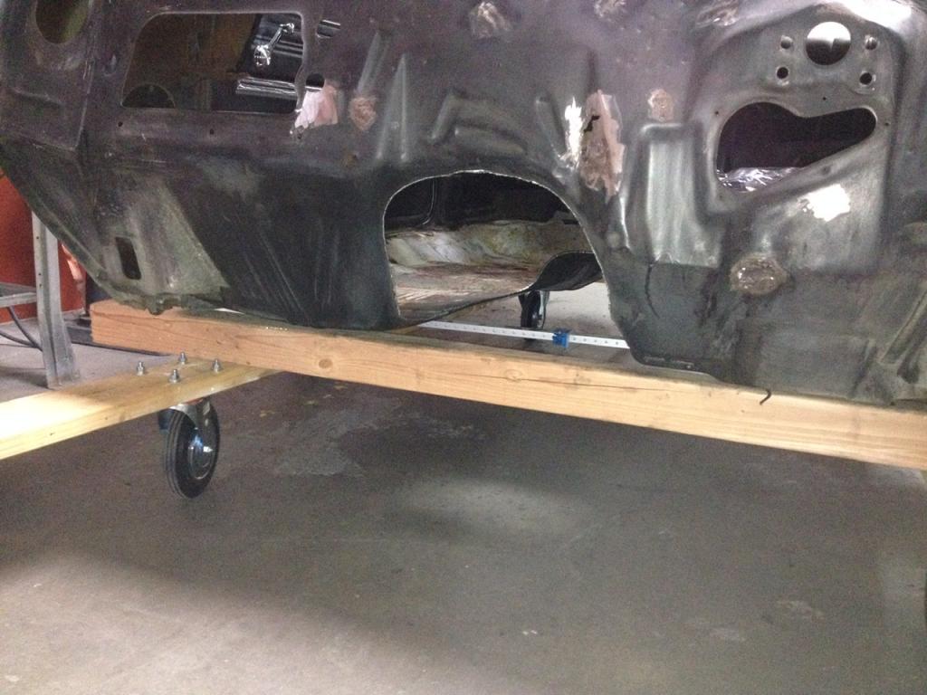

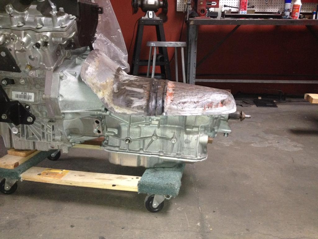

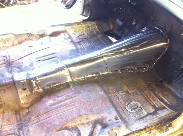

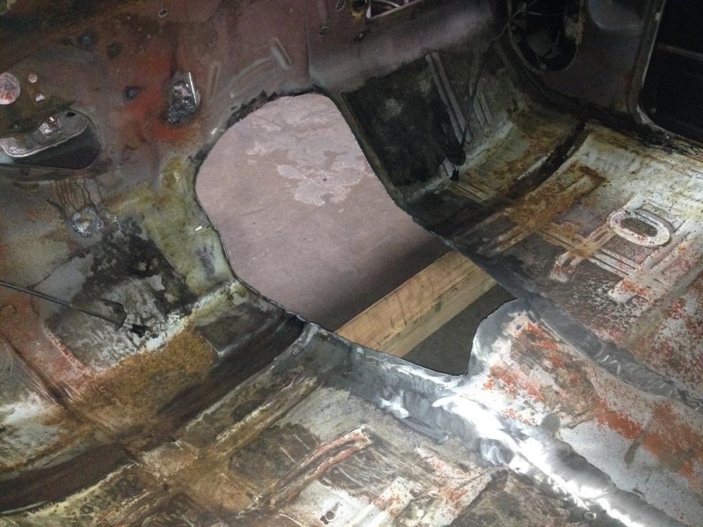

To set the body back down I had to enlarge the transmission tunnel. The new trans is huge and mounted a little higher for ground clearance and the proper driveshaft angle.
