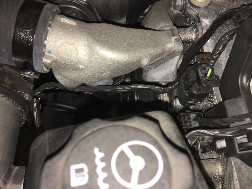

I had to realign the upper water neck. It was aimed down in the Camaro

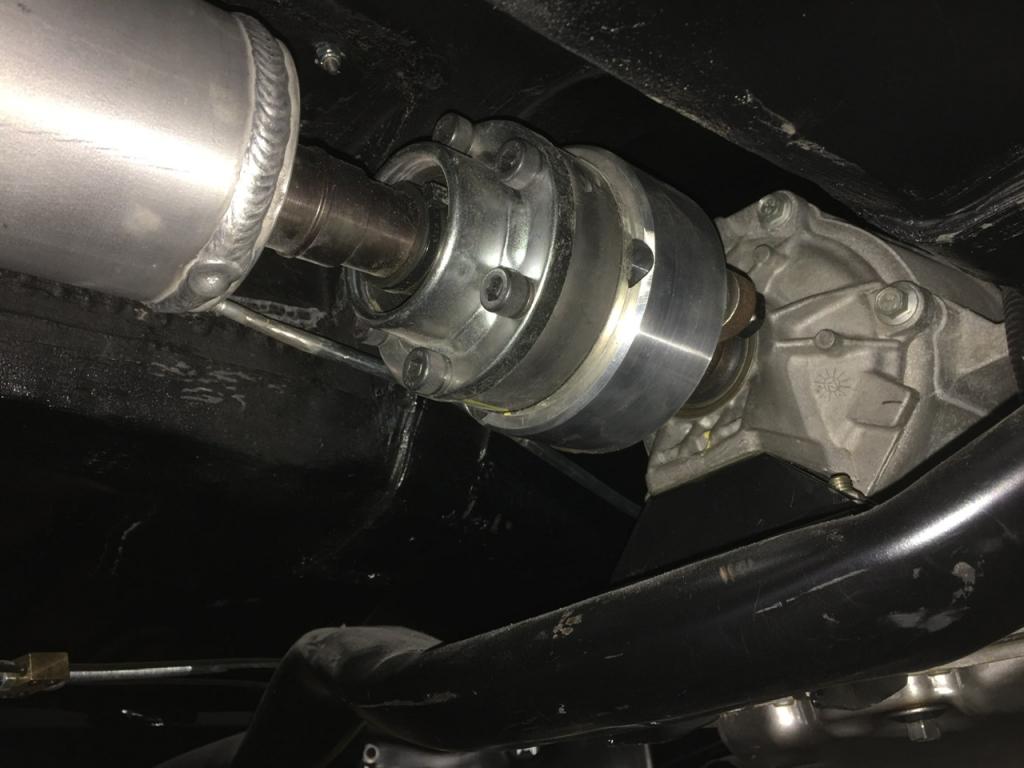

The drive shaft now has a CV joint on the front because the trans has no slip yoke.

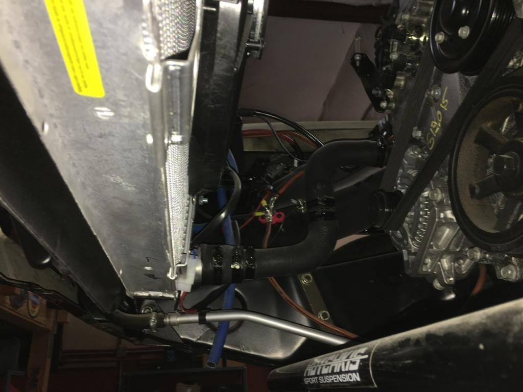

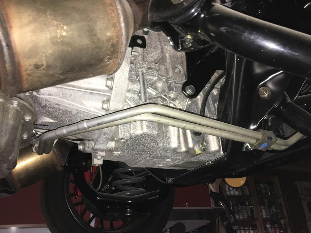

The trans cooler lines from the Camaro cleared everything. I just needed to extend them a little to reach the trans cooler in front of the radiator.

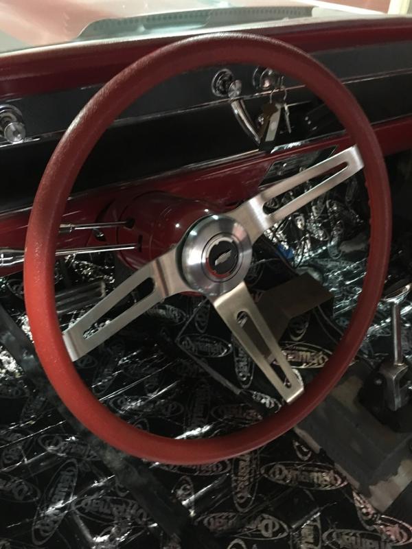

New steering wheel and Dynamat.
Notice, no gauges in the dash...
