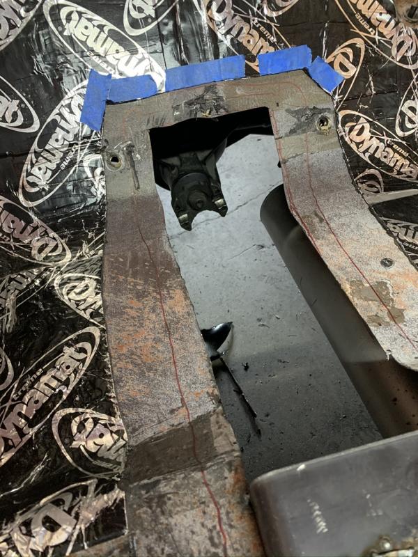

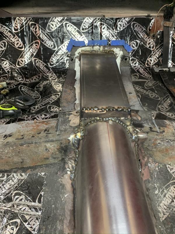

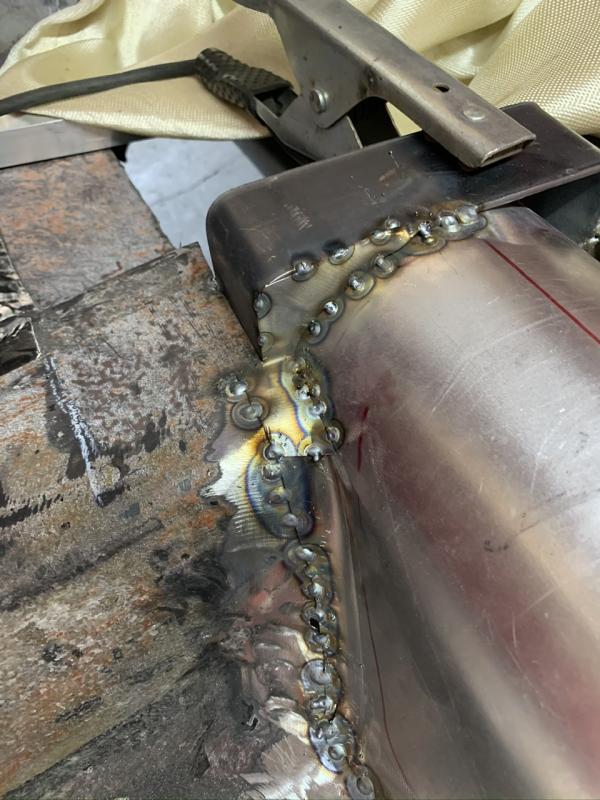

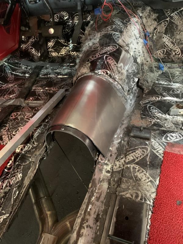

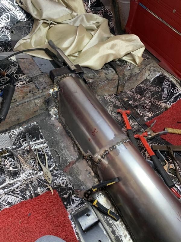

Cutout all the way to the back and now the tunnel is going back in. The tunnel under the back seat is flat topped to make the seat frame mods easier. Hopefully.
The complete tunnel will give me just under 3” more inches of clearance.
I’m still working on this so I’ll post more pics as I progress.
I still need to build a mount for the shifter and a mount for the custom console. A stock console would never fit these new floor boards.
And I’ll need to strip the rear seat back down to a bare frame and modify the frame to clear the new larger tunnel.
