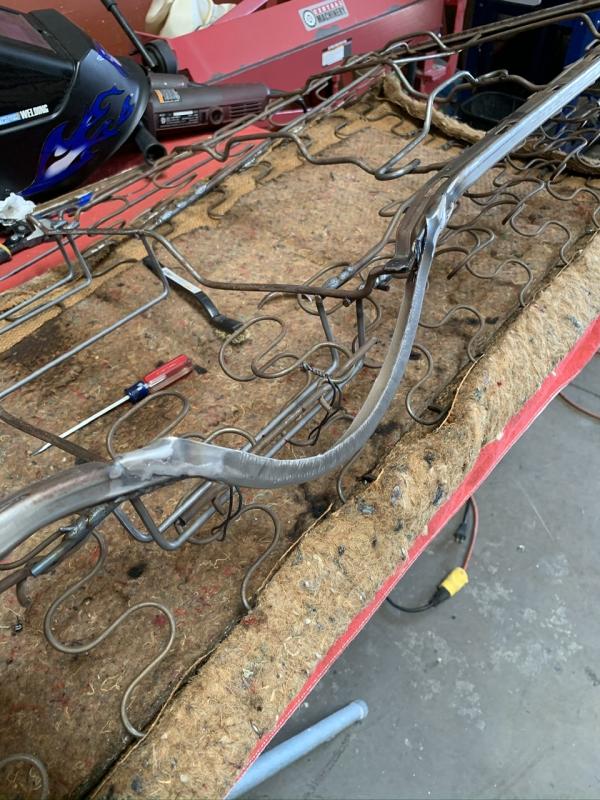

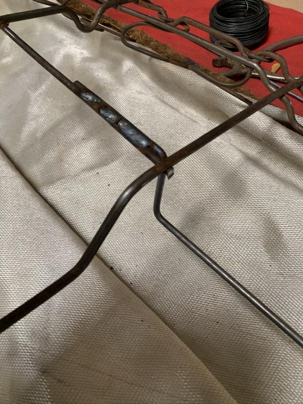

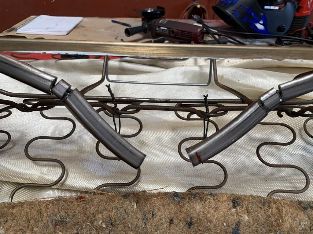

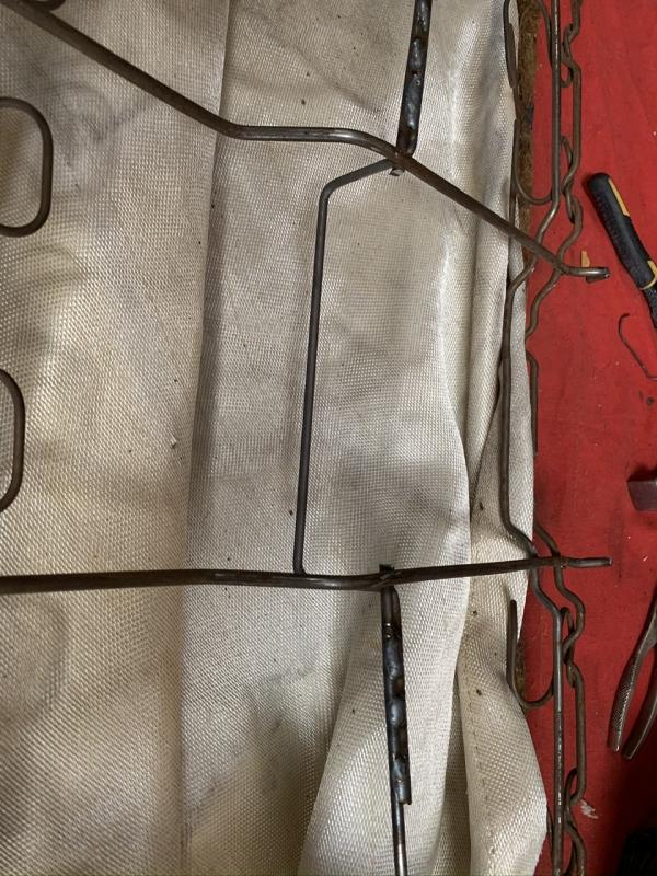

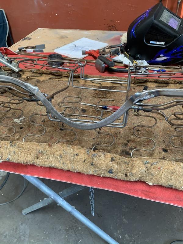

I’ve carefully removed the upholstrey from the back seat to modify the seat frame to clear the new taller driveshaft tunnel. The frame is 3/16” rod so I fab’d up some pieces 2” taller and welded them in. The front edge where the upholstrey attaches with hog rings I fab’d up by shrinking, stretching and welding a piece of 18 gauge.
