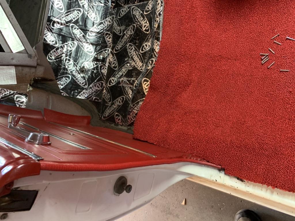

Back on the project and close to finishing.

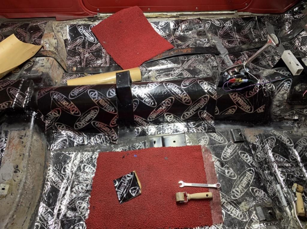

Driveshaft is back in.
Added Dynamat to the new tunnel

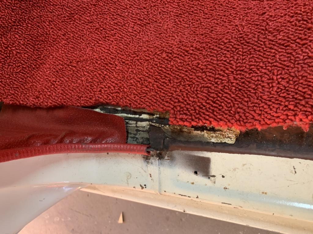

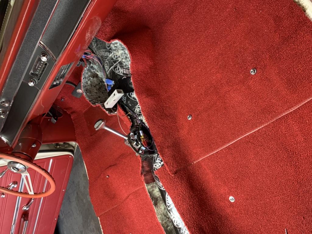

With the increased height of the new tunnel the carpet no longer reaches the door sills.
I cut the carpet up the middle and started at the sills and worked my way to the center. This way the seat and seat belt holes in the carpet fit again. I’ll have a separate piece made to cover the tunnel where the console doesn’t cover it.
