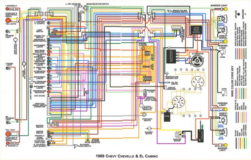

any one know the engine wireing diagram for the 69 chevelle any help would be great... i am lost and dont know where to go next... thanks

scroll down to 69 chevelle
http://www.wiring-wizard.com/how_to.htm

here you go
