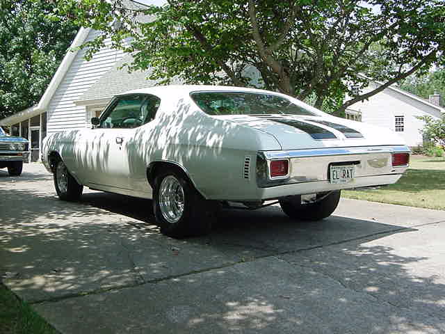

I had 15x7" fronts and 15x10" on the rear of my '70.

Thanks for your reply, do you remember if there was a specific backset to fit 15x10' in the rears?
Old 10-08-2014, 12:31 PM
Yes.... 5 1/2" back space

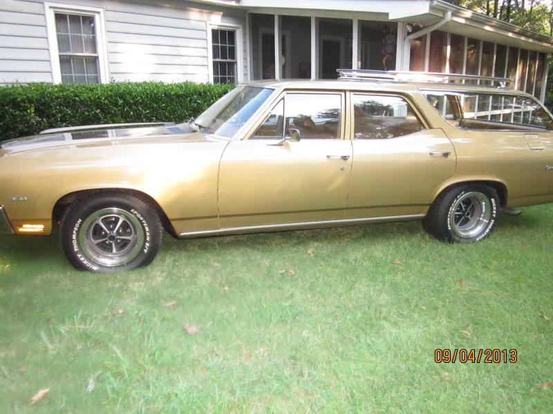

Same size wheels on this Chevelle...
