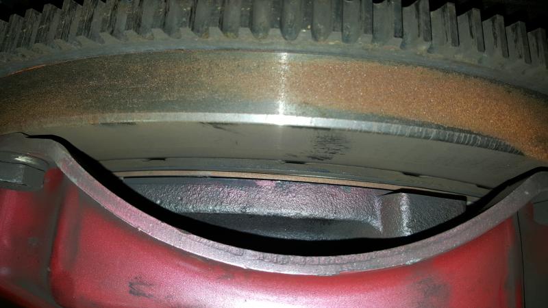

Lately, once in a while usually after I've been running for awhile, trans won't go into reverse, grinding. Pop it into first for a second and problem is gone. Yesterday did a 150mile run up to Maine, no troubles. When I headed home, trans didn't want to go into any gear easily. clutch pedal mashed to the floor. At one point, i could only start it in 1st with the clutch in. Checked fluid level, no issue. Checked clutch (picture) and there seems to be enough left. So I'm thinking this is a clutch pedal adjustment. Worried about why this happened after a long drive. I'm a newbie with this car and this m21 transmission. I'm I thinking right?
Thanks in advance for the help!!! Need to put more miles on this old girl over the weekend.

I would try adjusting the clutch. The grinding may be from the clutch releasing to close to the floor. On the slipping you may not have enough free travel at the top of the pedal (should have at least 1") or it may be time for a new clutch.
thanks for the reply. less than an inch of play for sure. ill try adjusting. does the clutch look like it's close to done?

It's hard to tell by the picture. If you do need to get a new clutch buy nothing but new stay away from rebuilt stuff.
