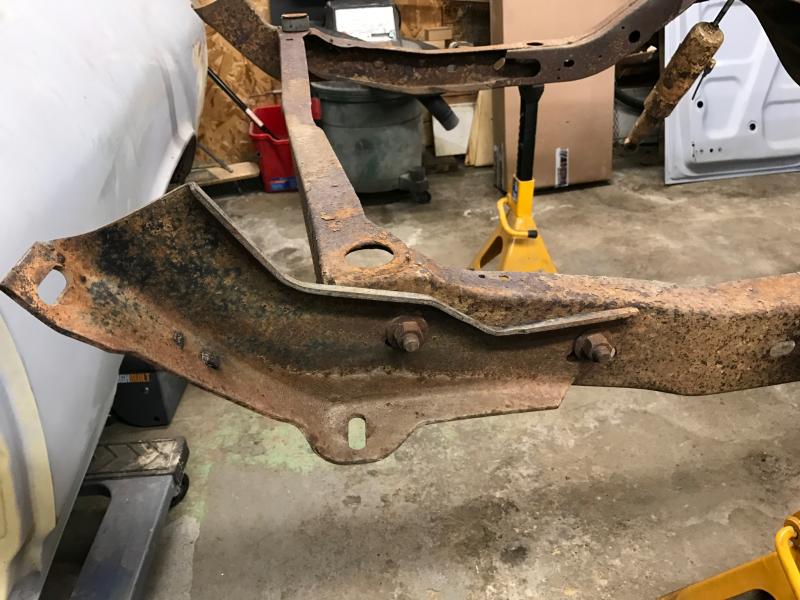

First photo: There's brackets on the ends of the frame. I'm pretty sure they're for the bumpers?

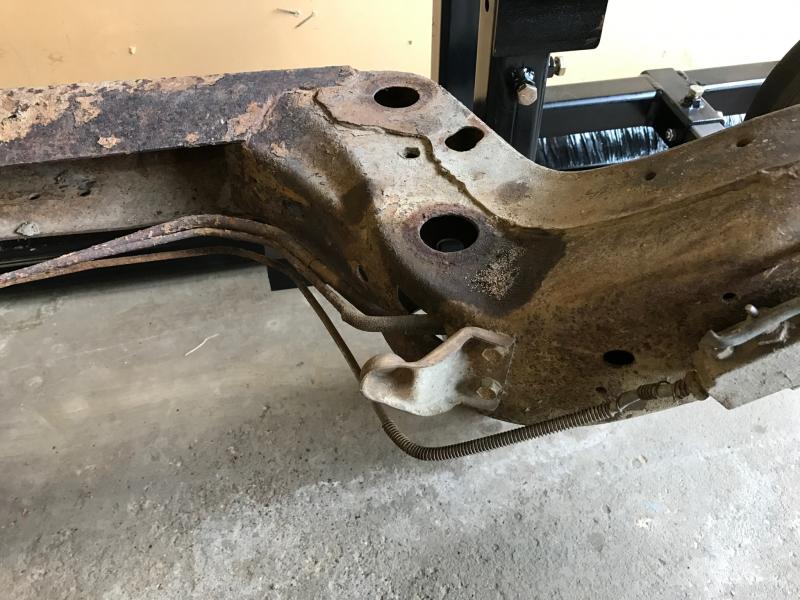

Second photo: What is the plastic skirt for

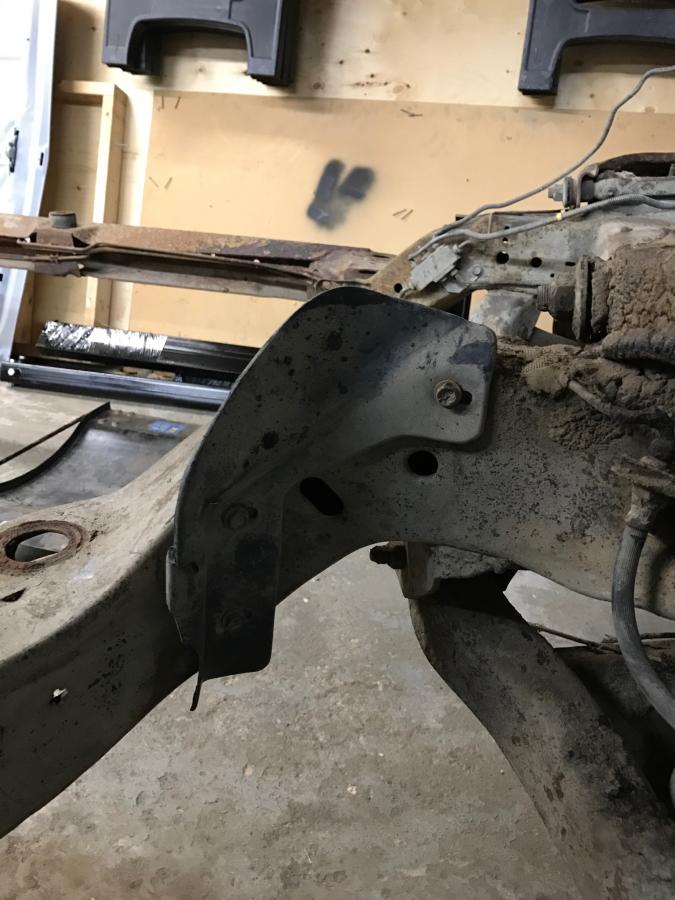

Third photo: what's the small bracket on the corner of the frame for

First pic...bumper brackets
Third pic...bracket for the shift indicator linkage from the column to trans
cant help with second...my 70 did not have that on it
