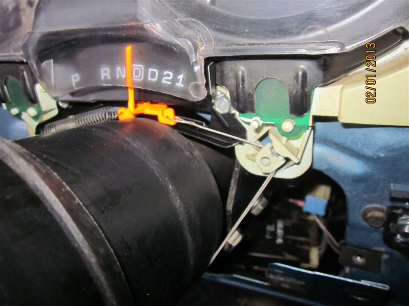

If I'm not mistaken, take the bottom cover off under the steering column, should just be 4 screws. On the passenger side of the column there is a philips screw and a tab with a cable on it, if you loosen that screw you should be able to adjust the pointer on the dash to indicate which gear your in. Adjust it for Park and then for L1 and the rest should fall into place.
Should be something similar to this
Justin
Projects: 70 Chevelle Malibu
