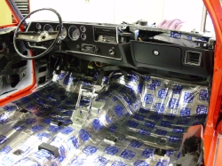

i used fat mat 4 roll kit from ebay few years back. headliner doors quarters floor rear deck. quiet and solid !!!!!
ID:	2188   Click image for larger version
