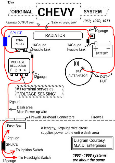

Because the engine stalls and all power is lost I would suspect a problem with the positive power side of the wiring not the negative or grounds. Not sure how different the AAW wiring is from original. Original +12 comes from pigtail off positive battery cable, through a fusible link to a junction block mounted on the rad core support behind the battery. From there to the driver's side to the main splice. From there to the horn relay, through another fusible link then to the bulkhead connector to the fuse block. You need a meter or test light to determine where you have power and where you don't when you lose all power. Below is diagram of the original wiring, you can check all connection points to make sure they're clean and secure.
