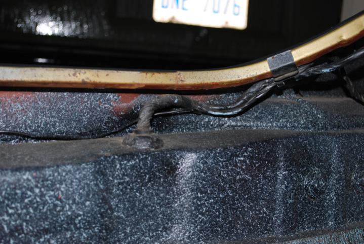

I could use a couple of pictures of the wiring in the trunk that is up under the left side inside in the trunk. Trying to figure out how it was clip up. Have asked other places and no luck so far. Hoping to get the wiring in this week. If I had taken it out I would have taken pictures.

First pic is flat cable coming into trunk. The orange and white wires to the left are the dome light wires.

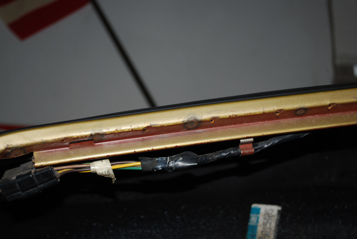

Second pic, more of the same.

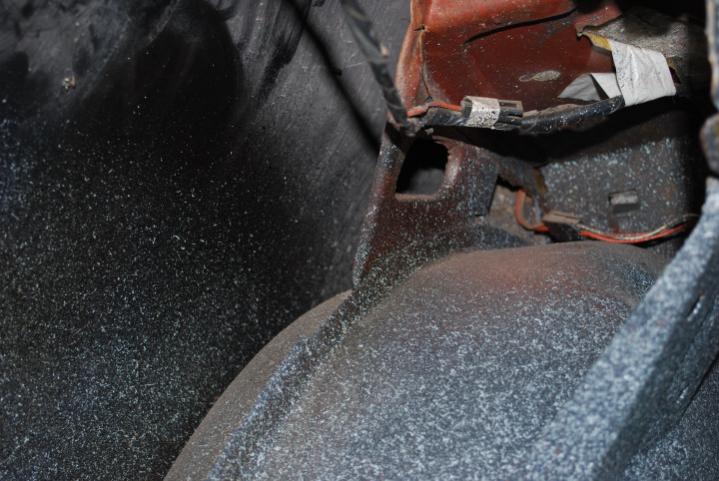

Third is tailight wiring running under driver's side lip of trunk. There is another clip forward of the one in the pic. One of the two is bent, probably the one in the pic because the other one holds the wire up higher so you barely see it.

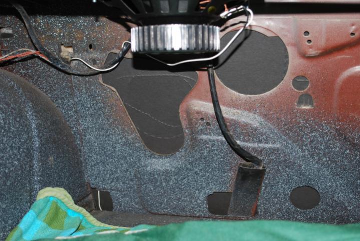

Fourth is rear of trunk. Harness clipped to lip where the lip starts to curve around to the back.

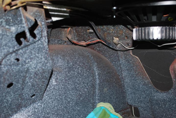

Fifth is another view over the wheel well where the domes light wires tie in.

Old 01-24-2010, 12:07 PM
Perfect thank you very much, thats just what I was looking for.
