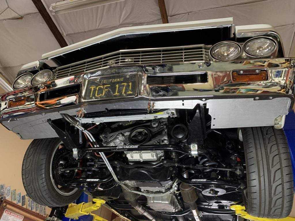

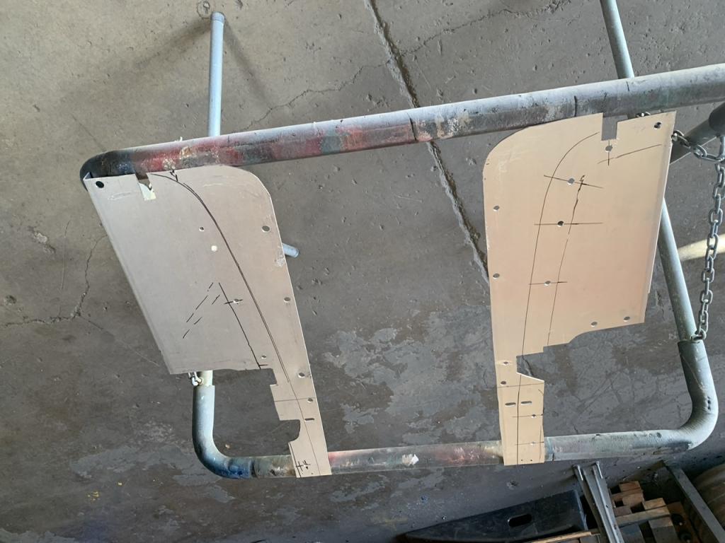

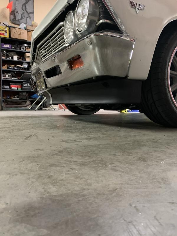

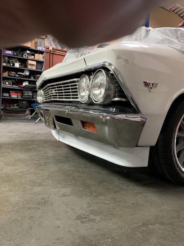

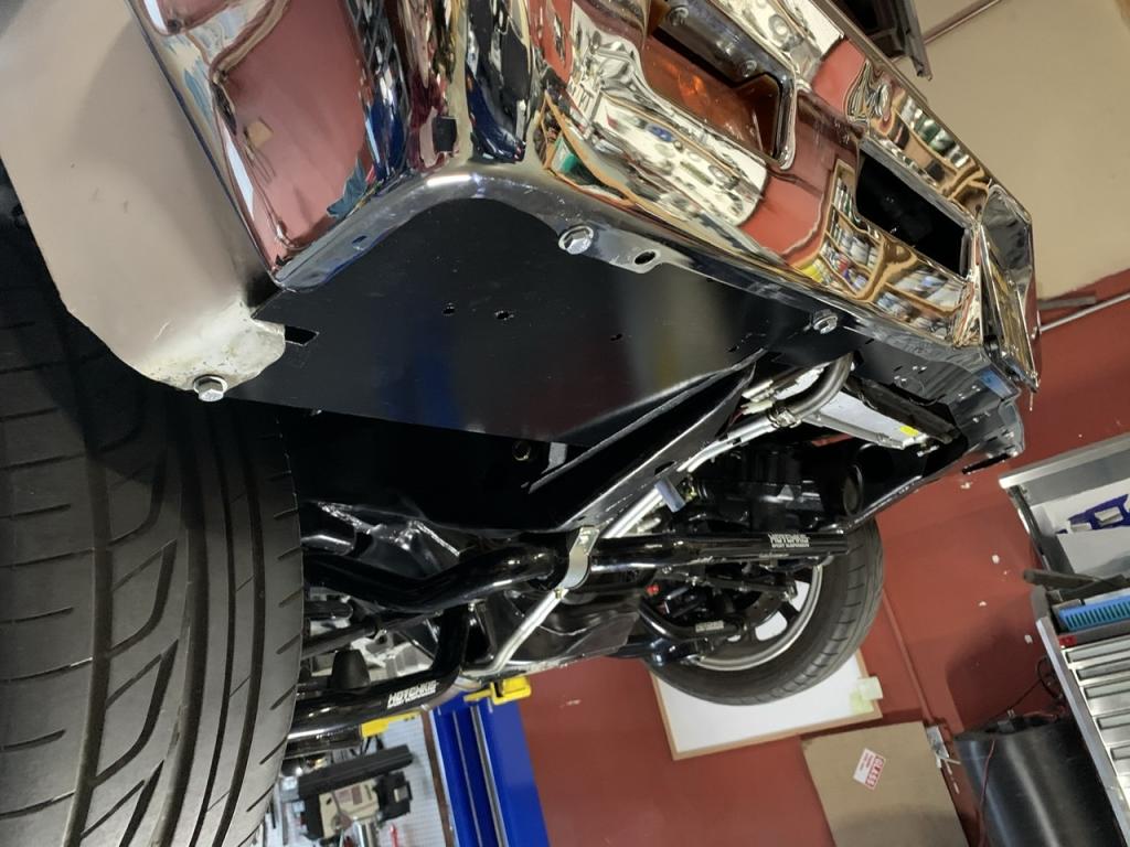

Finished up my front air dam.
I made plates to mount it behind the bumper. I thought it would look better back a bit from the bumpers edge.
It also peaks in the center and fades back to the sides and wheel wells.
I wasn’t sure if I wanted it black or body color so I sprayed it white with peeling paint. More like a lower valance. I can peel it off it I didn’t like it.
What do you guys think, black or body color?

Old 12-22-2020, 05:04 AM
I like the black..
Old 12-24-2020, 11:34 PM
67-ls1 67-ls1 is offline
Join Date: Mar 2020
Location: Walnut Creek, CA
Posts: 92
Yeah, I’m thinking black too. It kinda disappears that way. The white stands out to much.
I guess I’ll start peeling....
