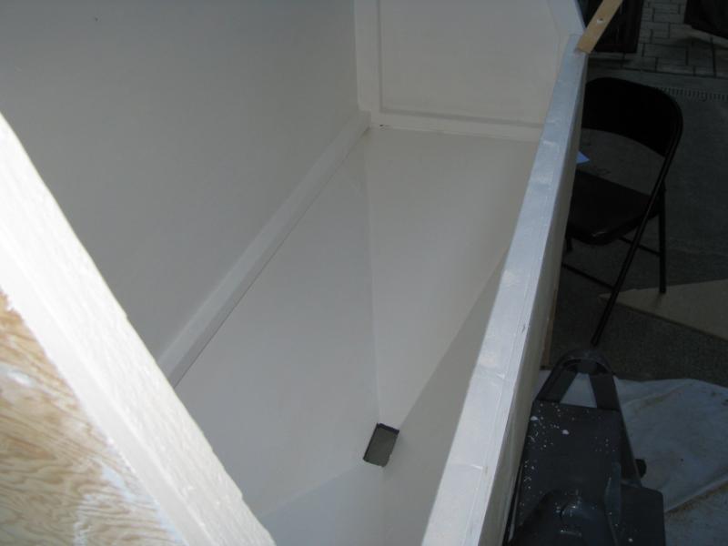

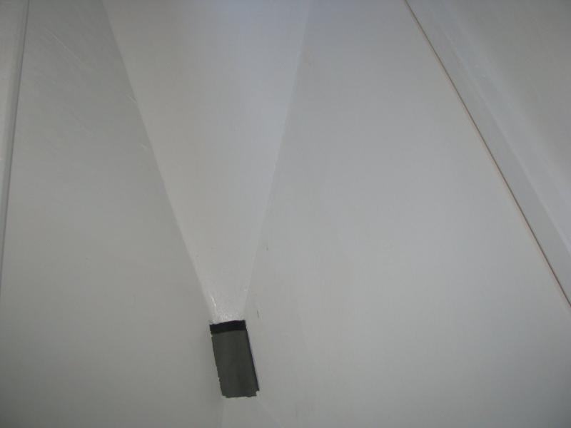

bottom done ..caulked and 2 coats of paint to help media slide down..[IMG][/IMG]

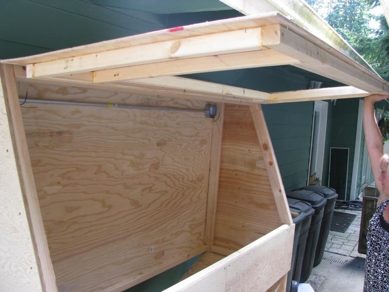

next is to hook up the (2) lsealed lights in the corners.....drill in the filtered intake as well as the filtered exhaust (hooked to a shop vac).. get the glass cut and installed.....drill the 4 holes for the 4 gloves for full access....and then finally set the grid system on the bottom to hold the blasting projects flat above the slanted media drain area.....on the bottom i will have a screen belowe the drop shute that will catch the big stuff and the media will drop into the bucket to be continually reused....in theory it works..but the testing coming up will the final say in the matter...lol...outside will get painted to match house so it doesnt look to obtrusive..it is big..you can fit a core support front piece with room or a full sized complete fender inside....trying to make it as useful as possible...there are many more cars to do after the wagon is done...

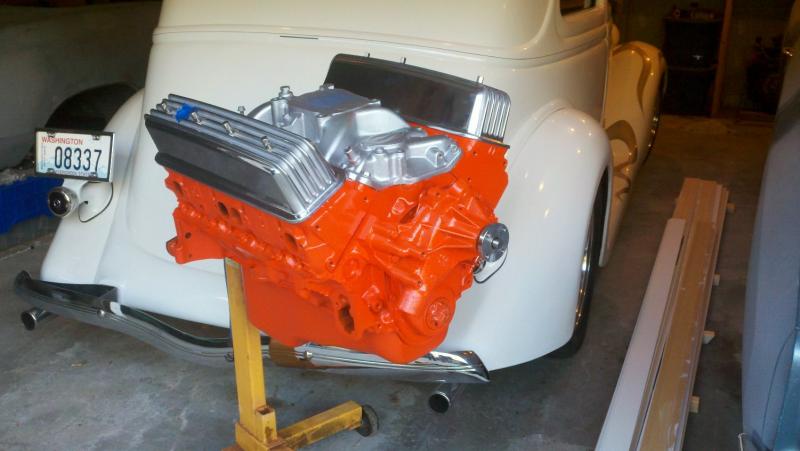

[IMG][/IMG]
here is the pic of the motor going in the wagon....it is a 86 350 ...bored 30 over...stock cam...just a nice smooth running stocker... ))

Smile
btw ...thats a sneak pic of our 35 ford sedan that we show when we have the time...lol
