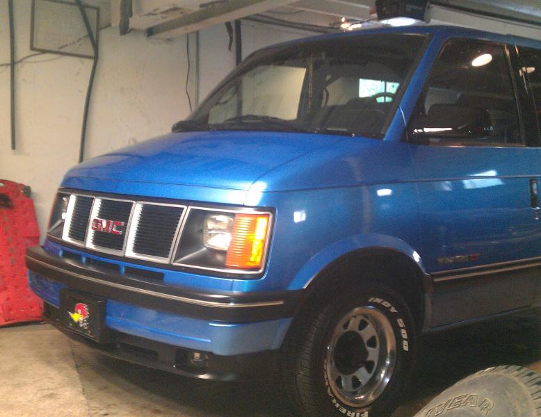

I do collision work and rust repair for friends and family. I have done my van twice because it keeps getting hit.
I did it some in my late teens. In barns no less in true hillbilly style. Then 5 years ago I gathered what i needed. Compressor with proper CFM rating. Monster air storage tank. Good guns and hoses water trap etc etc. LOL I even refused a house and got this one because it had the big garage. I just knew somehow. You grow up but really you never change.
I can't afford to have it done. It expensive enough just buying supplies. I knew this car was finally coming along. Frame finished rebuilt the front and rear end. Metal work done then the long journey doing the bodywork. Most of the time i was working only on the weekends if i had time. Building houses and remodeling houses took all my time. Like building part of mom's house last summer. Now I am semi-retired and got the time to do more. I wanted this car bad enough to build it from scratch. I sure can't afford one. So I had to get with the program.
I grew up as a kid watching Jim Garrard paint cars. He did cars for shows. I am not a pro but i seen it done and know what should be happening. I do the best I can. I am not the best. But i don't suck like i used to either.
This has been a dream to do this since i was a teen. I had 20 chevelles back then when they were cheap. But i just dealt with what I had and made them look as best I could. Then they got to expensive and I gave up on them. Got a bike a while.
Then I saw my car my color with a big block. I had to have another one. I paid way to much for this rust heap and I been trying to make a decent car out of it every since. I look at it and it gives me shivers knowing what I done and it getting so close to the day I can fire it up and drive it.
This is the last thing i painted if it turns out as well I be pleased. I never even buffed it out. This one is definitely getting sanded and buffed.

That van looks great and its got my picture on the tag ,one of my friends calls me PeckerHead because of that emblem. I had some hats printed up with that logo and PeckerHeads Car Club on it and gave her husband one .
