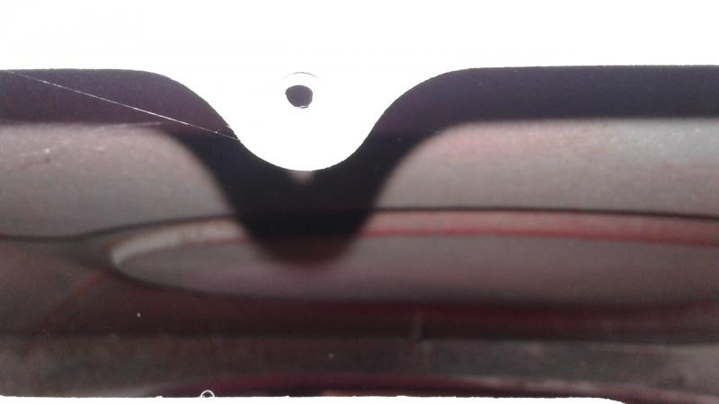

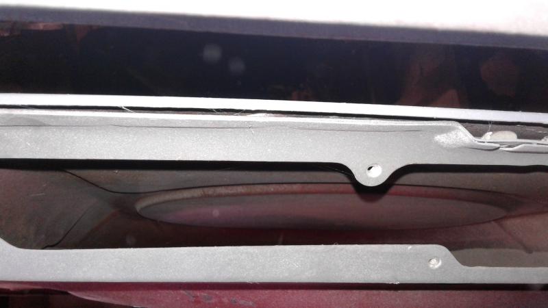

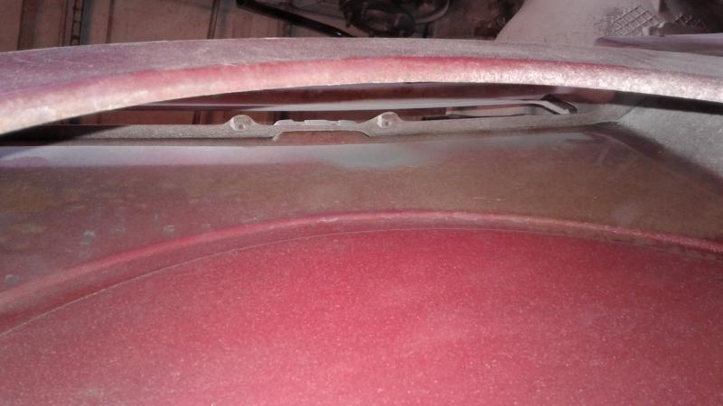

Yes, from what I can tell there is no opening to the rear except a small area about half inch by two inches long. You can see it in the one photo at the top of the off set

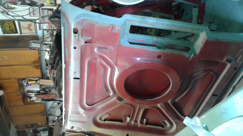

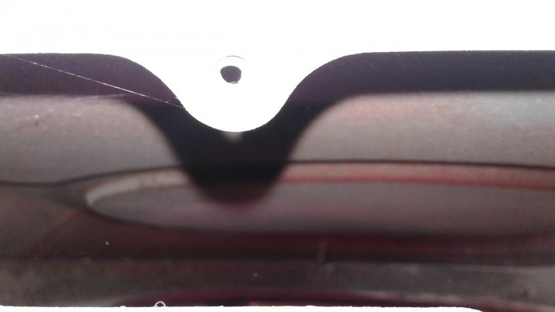

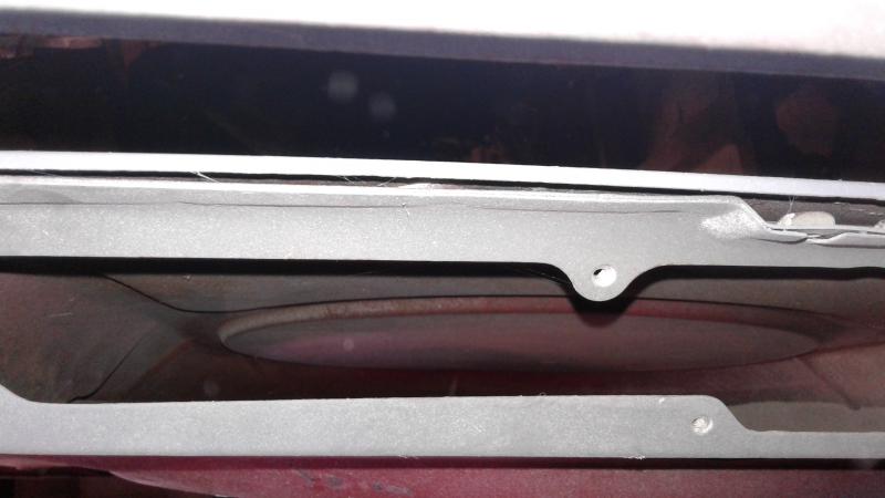

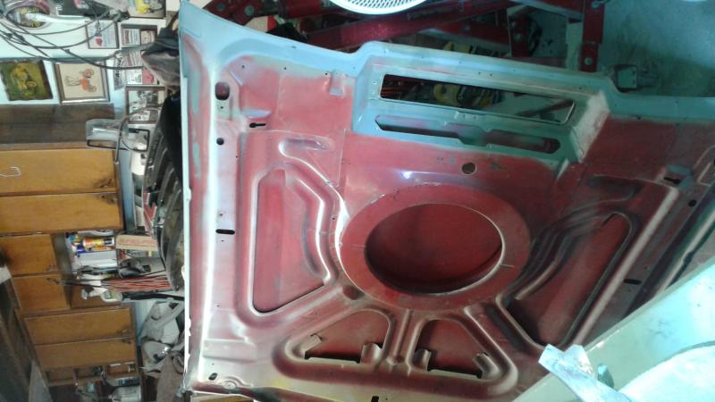

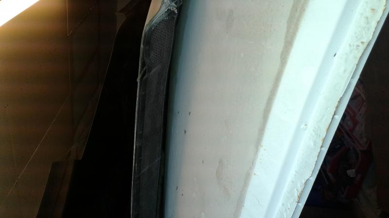

Ok, first my flapper hood...
ID:	4202   Click image for larger version
ID:	4203   Click image for larger version
ID:	4204   Click image for larger version
  #15
Old 09-23-2017, 09:17 AM

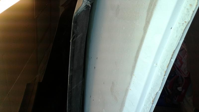

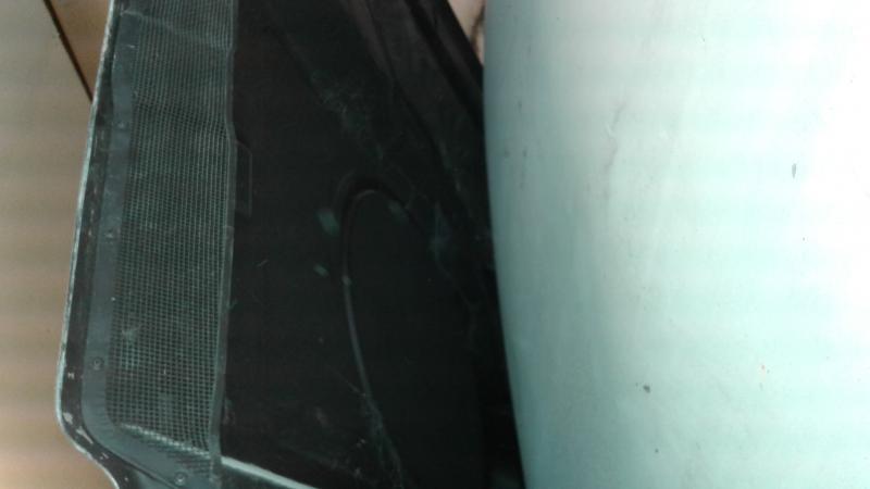

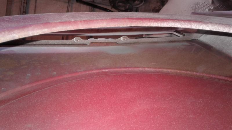

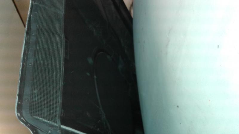

Now the domed hood...
See the obvious difference between the inner structure? Hence why I recommend an air pan to make a domed hood functional.
ID:	4206   Click image for larger version

OK, I see what you are saying, mind is the domed hood. Thanks for the info. Would like to make my inlet to get some air in. Thinking all I have now is just through the air breather inlet.
  #17
Old 09-25-2017, 12:10 PM
You are most likely picking up air from the engine compartment. Go with an air pan set up. Simple to fabricate, or they sell trim to fit kits.
