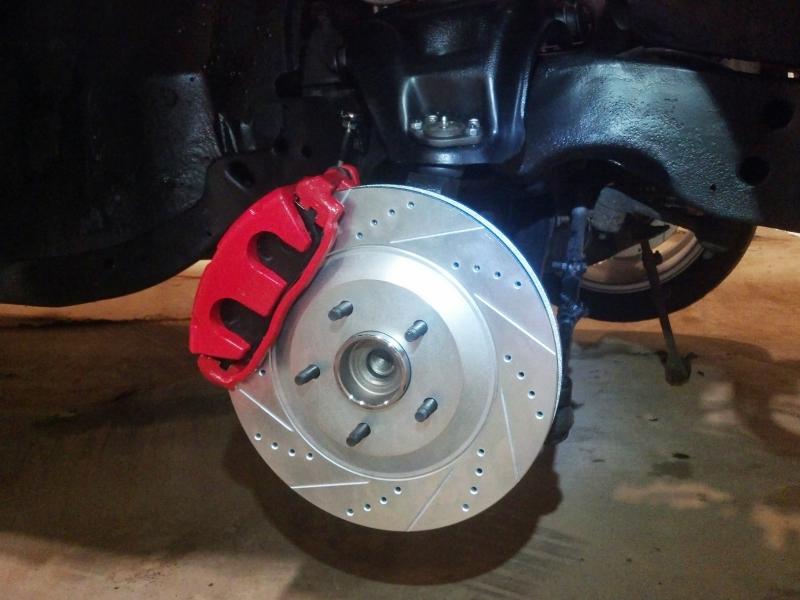

I never noticed that until you said something about it, but I finally got mine after almost 3 weeks and it has a brake bleed on the top and bottom of the caliper, maybe cause it twin piston? I dunno... Haven't bleed them yet, but I figured I'd put the pictures in case someone searches the forum for this set up. They whole kit comes pre assembled, so it's pretty much just a simple spindle swap, but the spindles I received already had some surface rust on them so I took them apart and cleaned them up and painted them. Here are a few pics from where I started to finishing up.
The spindles out of the box.
Little bit of rust so I went ahead and took care of it.

What I started with
I didn't really take any pics during the swap but this is what I ended up with

Old 09-14-2013, 09:29 AM
Posts: 446
great job quadracer....looking good
Old 10-18-2013, 07:43 AM
ycgoat ycgoat is offline
Join Date: Oct 2013
Posts: 4
Looks good. Have you driven it to see how it affected handling?
