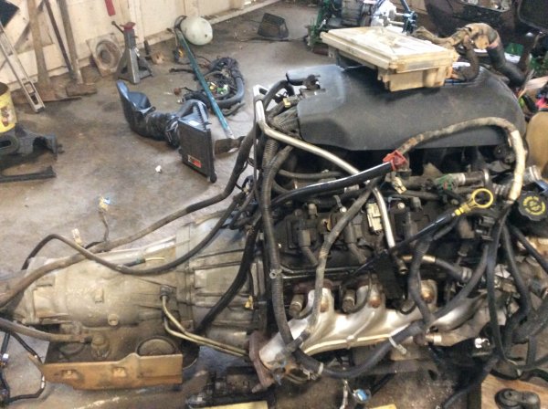

Where did you get a deal on the LS Set up , I need another one ?
  #12
Old 05-25-2019, 09:39 AM
Local...Douglasville
Was a complete dropout...harness, all accessories, CPU
I saw the truck it came out of.
Pulled the heads...cylinder still had crosshatch hone marks.
I'll keep an eye out for you...anything special ??
I've still got intake, TB, exhaust manifolds, harness, and CPU if you can use them.
