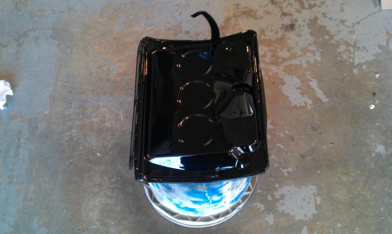

Really really shiny. Looks very nice.

Is that a gloss paint on the top of your dash? If so, make sure you always have your sun glasses with you. You might get a lot of reflection from it.

I have done it on other chevelles. Angle of the windsheild it isn't in your eyes. Dash pad blocks direct reflection.

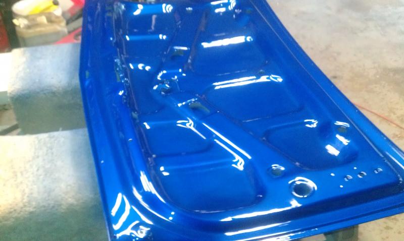

Got the inside of the glove box door and the lower dash done today. Can't tell from the pictures but it turned out as well as the top of the dash. Sun and brighter outside than in the car messed with the camera.

You are really coming along. Looking good.

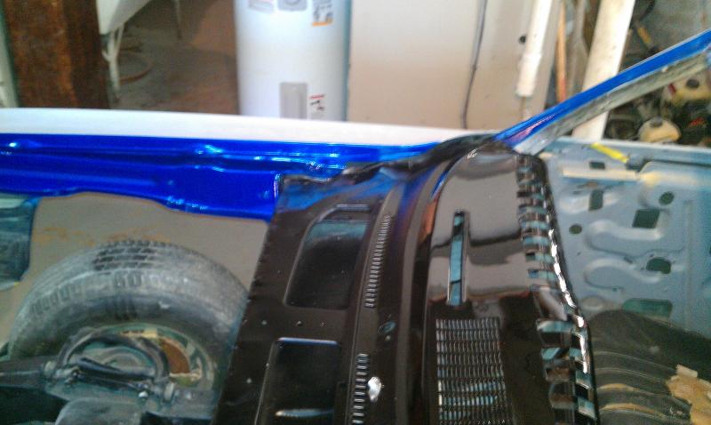

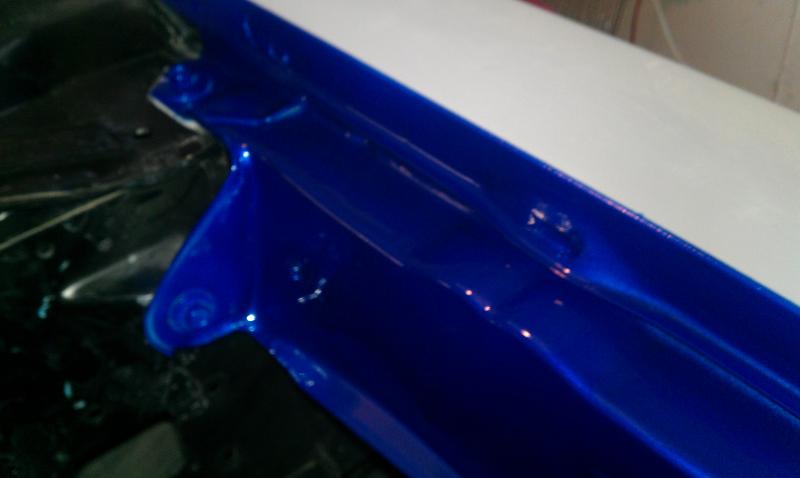

Old 04-26-2014, 12:49 PM
I got the hood jamb area sprayed. Now I got to put the front end back together. Go to one of the doors. I got a couple areas to touch up once it dries but decent overall.

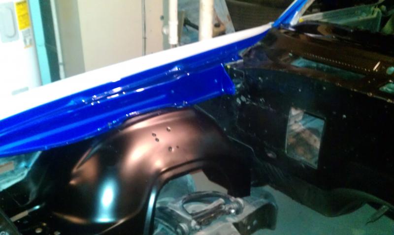

Old 04-27-2014, 05:19 PM
Nothing exciting. i got the front end back together and lined up. After the drama I went through lining everything the fist time. 68-69 chevelle hinges are a pain. I made 1/16 inch holes and made guide pins for re assembly. 2 on each hinge to fender mount. 1 on each hinge to hood. Slide the pins in tighten it down. Closed perfectly. Nosepiece was not tight when I did the body work and expected distortion when it was torqued. Nothing the final blocking wont cure. If left as is I doubt anyone would ever notice tho. It already way better than factory. Next on to removing the passenger door. Replace the lower hinge and jamb it out.
