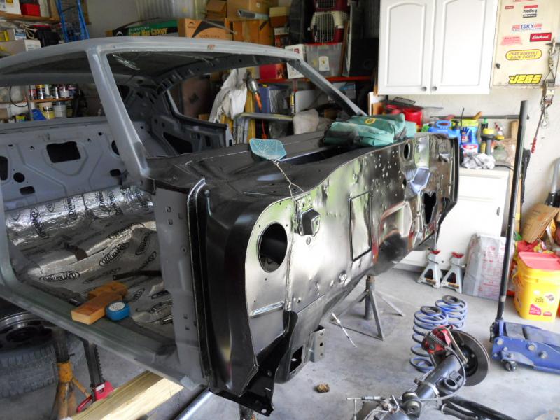

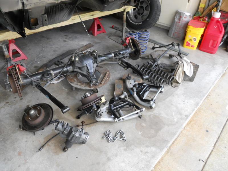

Posts: 446

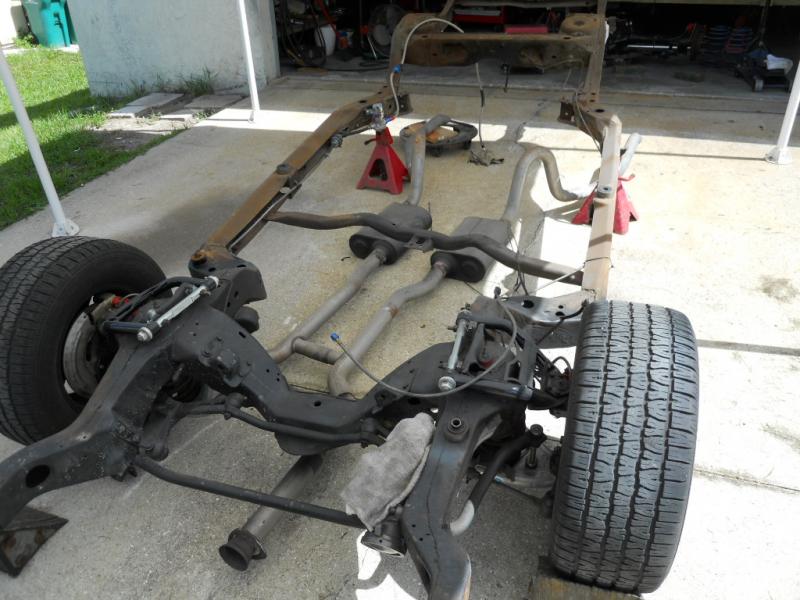

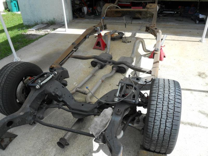

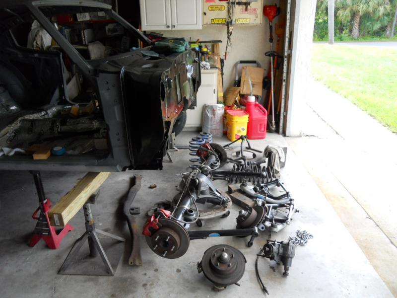

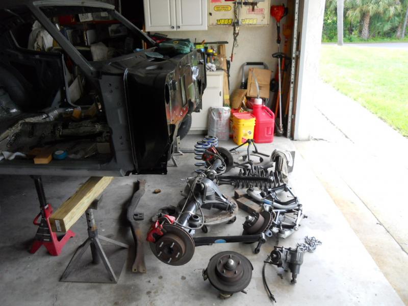

Update pics....im geting closer.
Frame going to sandblast soon and under body geting cleaned and wire wheel
perhaps some blasting
Looking at some 2k products to use under the body
Frame will get epoxy and single stage urethane.

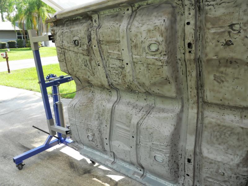

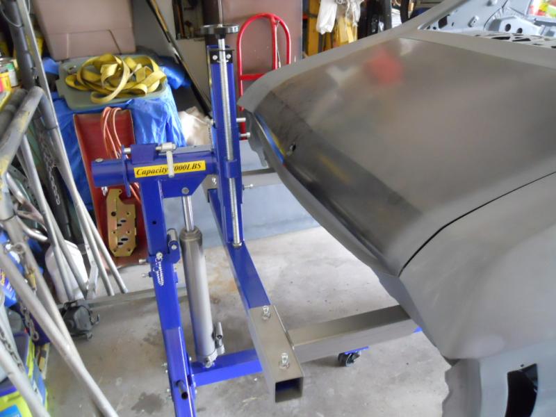

Old 08-02-2015, 03:41 PM
Posts: 446

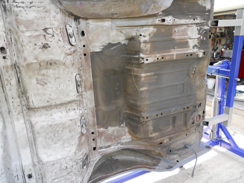

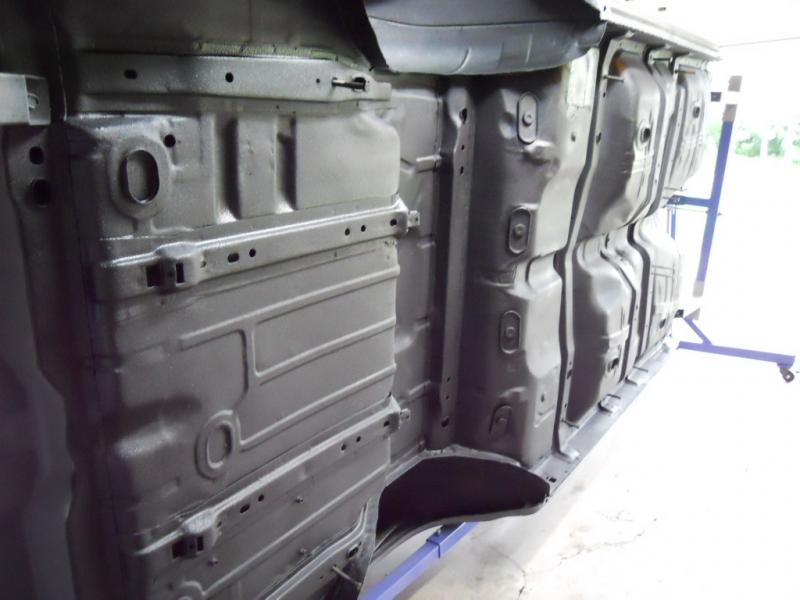

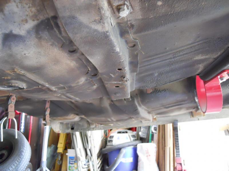

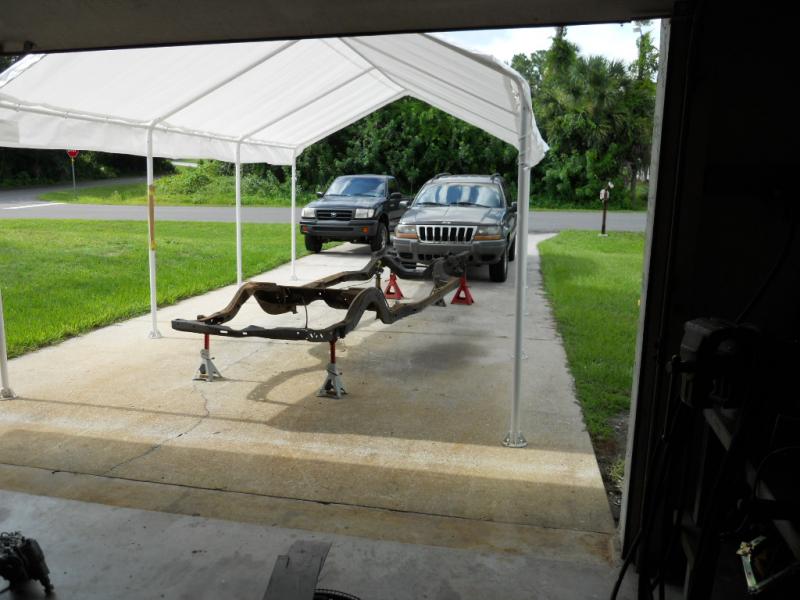

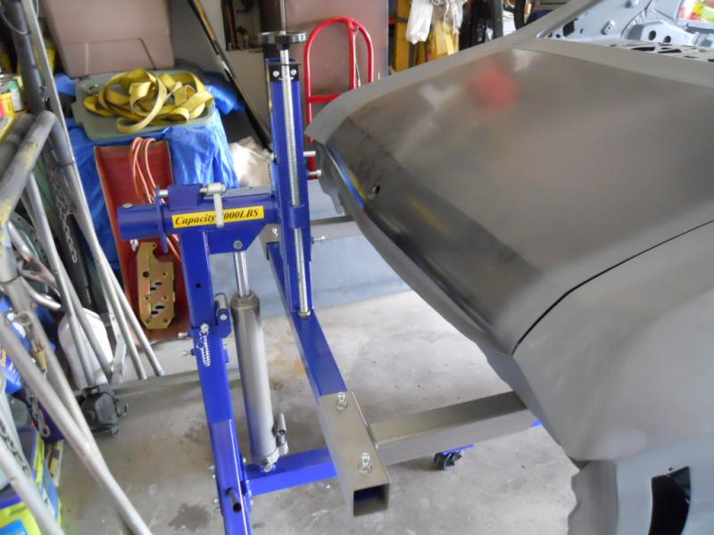

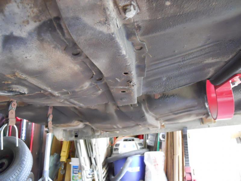

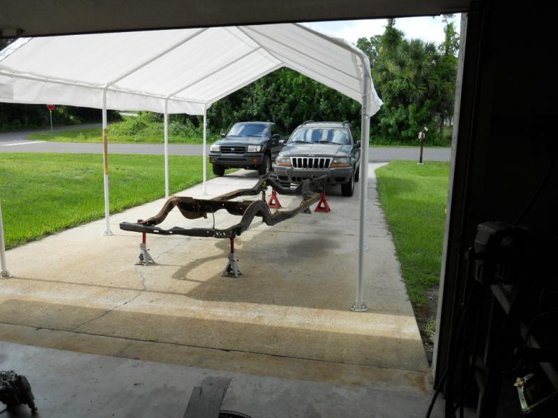

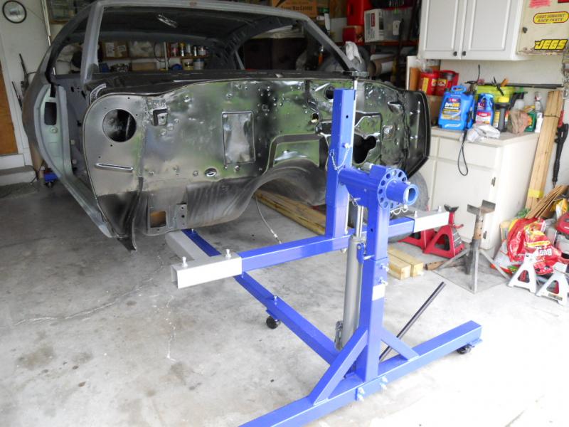

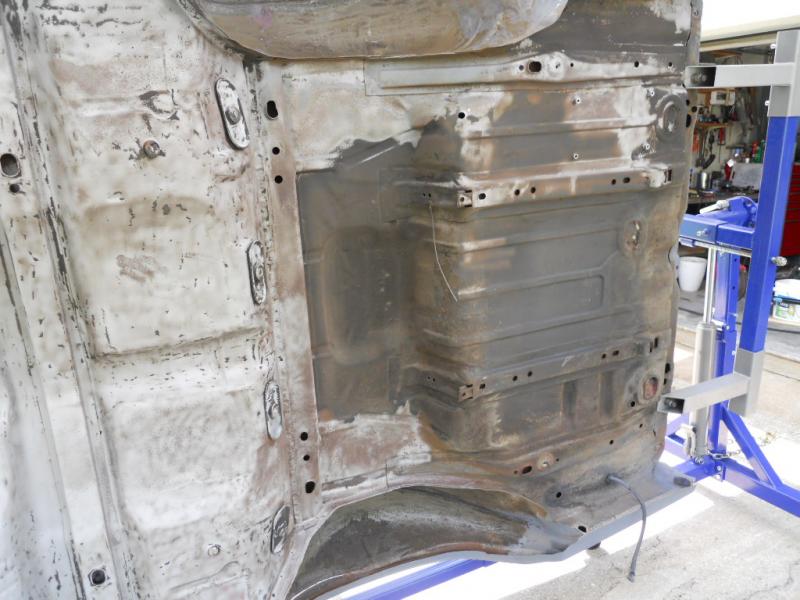

a few more pics.
Decided to buy a rotissserie....and sell when im done.
The weather has been crap here in SW florida....rain rain rain.
So the frame still in the driveway....and no room to push the body out to blast under it.
Im removing most of the original undercoat with hand scraper in the garage.
Only slight surface rust and 40 plus years of road grime so far....fingers crossed

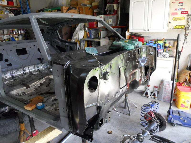

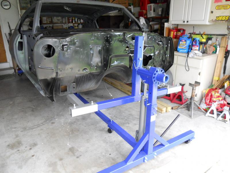

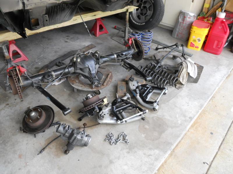

Old 08-12-2015, 09:27 PM
Posts: 446

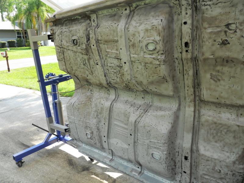

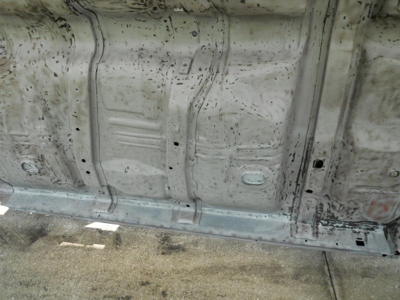

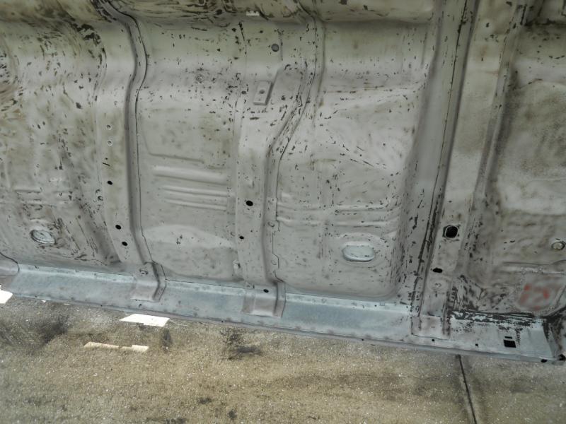

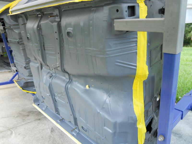

The frame went to sand blast...told em to keep it for a week or so.
Ive got 18 hrs of blast and scrape on the underbody.
Decided on epoxy prime then raptor bed coating.
A little more work and i should epoxy on friday and raptor saturday.

Old 08-12-2015, 10:56 PM
That's a nice dry car. The floors look excellent.
Old 08-13-2015, 08:51 AM
Posts: 446
Thanks carpoor.
I got this thing when i lived in cali...and finaly found the nice part of it.
The whole car was nice in cali but siting out in the florida rain took its toll.

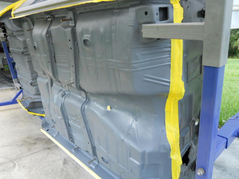

Old 08-17-2015, 09:12 AM
Posts: 446

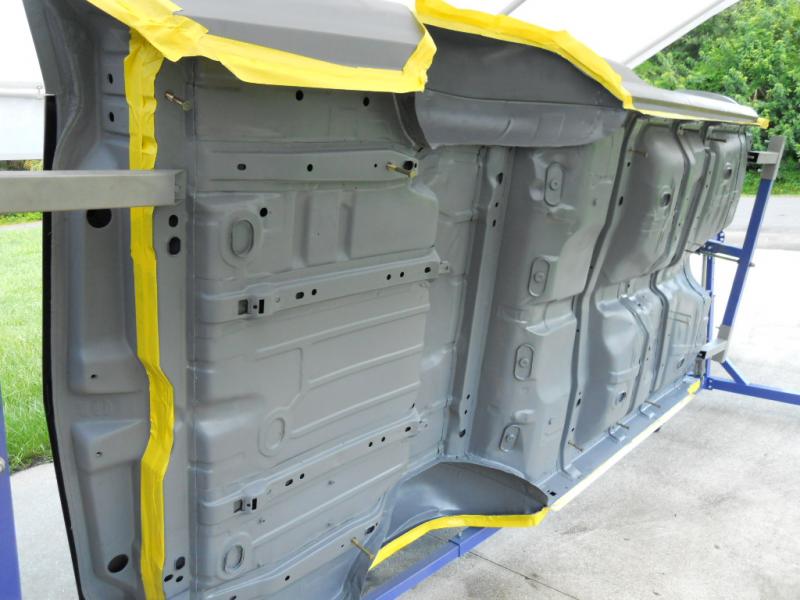

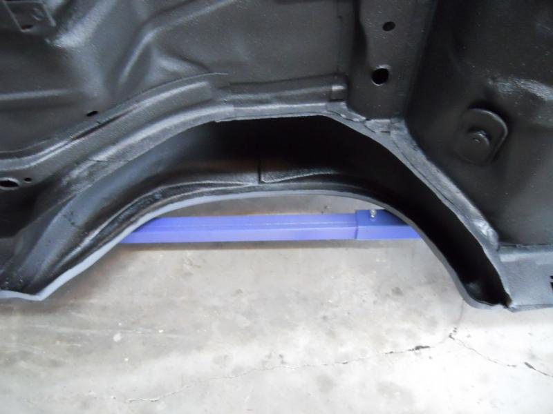

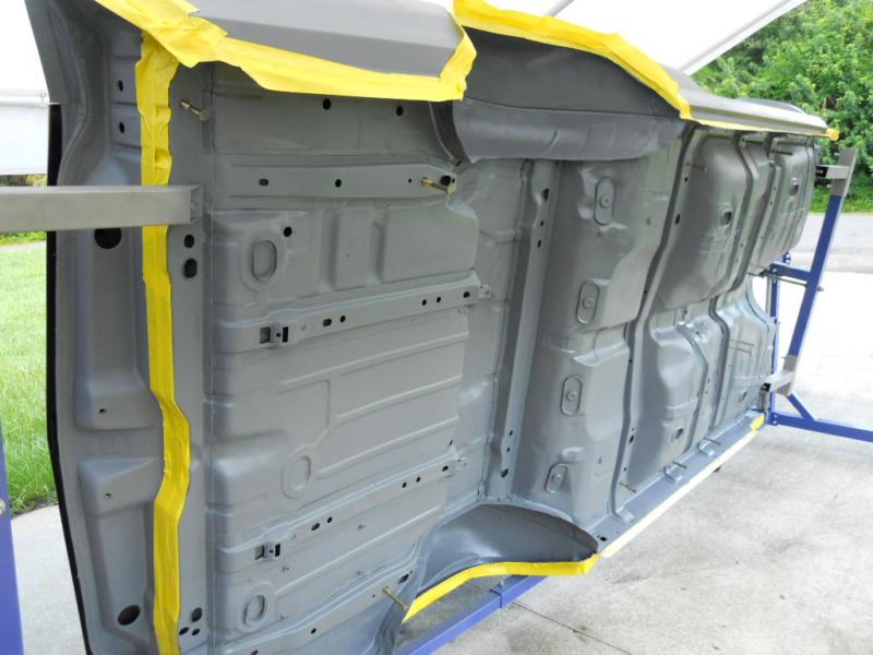

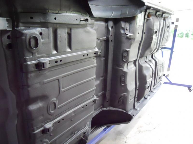

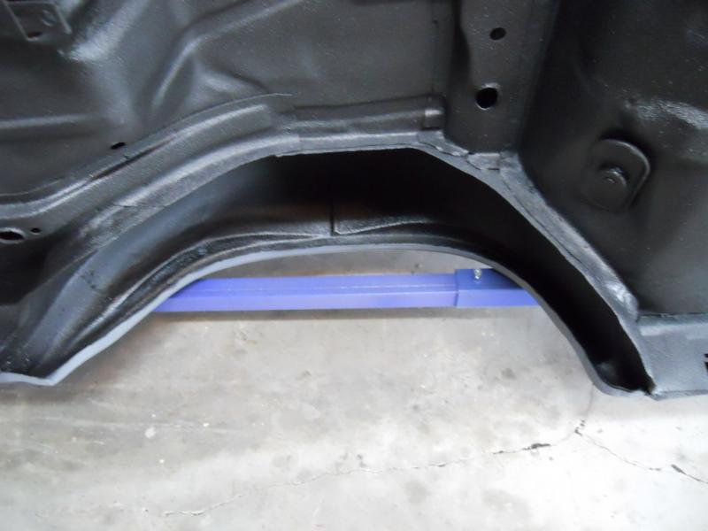

And here is the underside in epoxy primer
Then in raptor bedliner.
