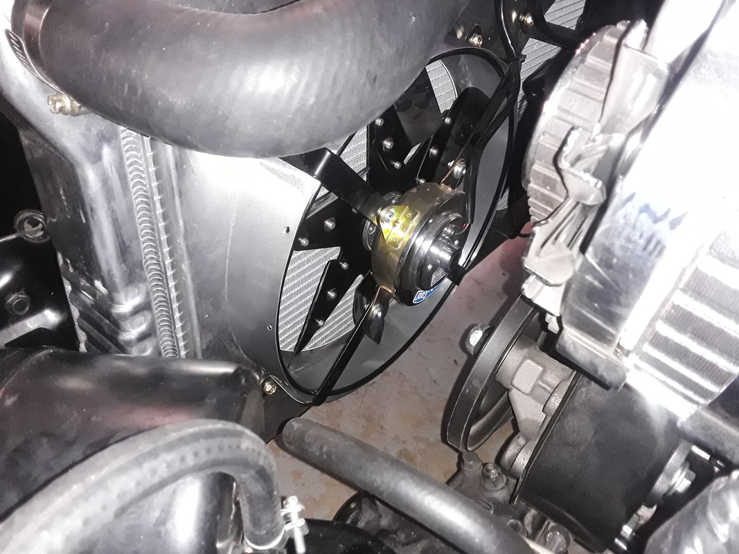

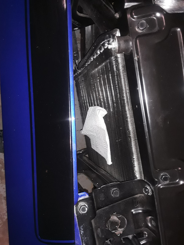

Weather is way cooler frosty even. I fooled with the shroud. Made it seal to the fans better,. Haven't had it out last week we had alot of snow. The baby isn't going out in that.
I zip tied them on and ultra grey on the bottom to seal. Picked that color because it blends in. The a/c condensor is 3-4 inches from the radiator and open on the sides and bottom. It has enough flow to hold the paper towel I think it is a improvement.
