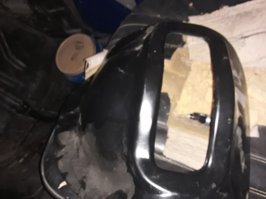

I got the block in today. Now the bell housing and trans so I can cut the hole and fool with the Z bar.
  #73
Old 12-18-2019, 04:05 PM
I got the bell housing and trans in. Crossmember is back in.
Now got to wait for a day mommy isnt working so I can use the whiz wheel and cut the floor out put the hump with the 4 speed hole in it.

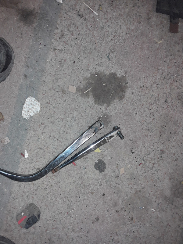

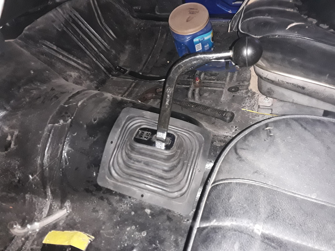

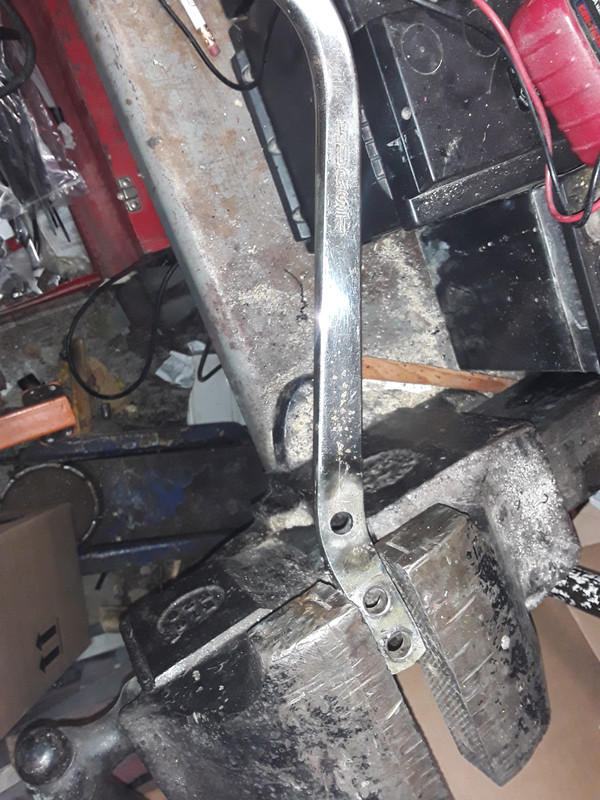

I got the hole in the floor and shifter in. That shifter was out of a 72 truck. It is a bolt on handle. I had 3 of them. The charger one was seat level way back halfway on the seat. The shorty one I got I am not with that. I can shift just fine with the 66 factory hurst I had I wanted that back.
So I took the truck one re drilled the mounting holes and cut and ground off the unwanted part. Then bent it for console use. Perfect now for me arms reach in all gear sitting with my back on the seat. It is a 220 muncie. I am getting the O/D from gear venders to. 373 a little to steep for freeway to me. I am old it is a toy. Cant take it with you when you die right spend it.

Got parts coming everyday now. I ordered the correct shifter for this mess.

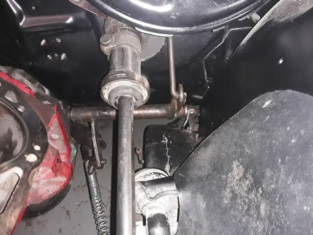

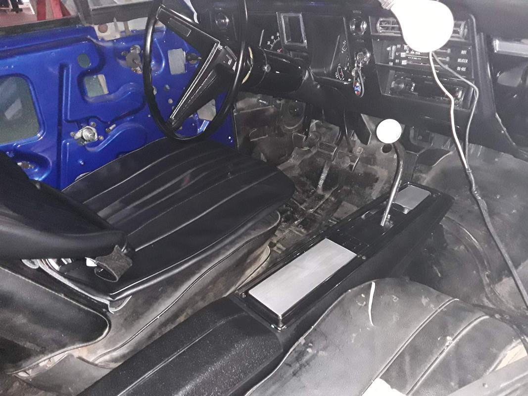

Since this was a auto car and the engine had no provision for the z bar pivot. I spent the last couple days making that stuff. Bell housing had the pivot. I drilled the z bar and pedal for brass bushings. Solved the wear issues.

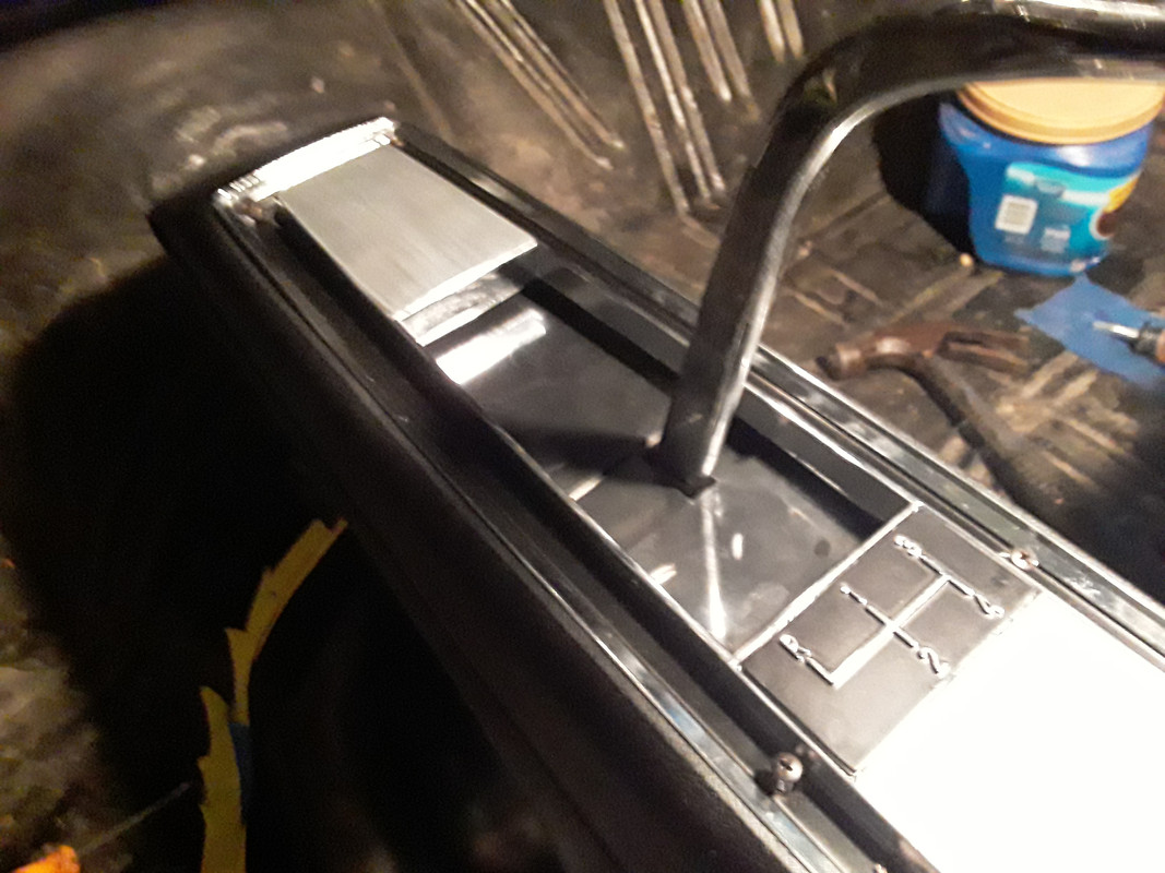

Once I got the console it was clear the shifter i got was in no way shape or form going to work with it. So I got the chevelle hust comp plus shifter for consoles on the way now.

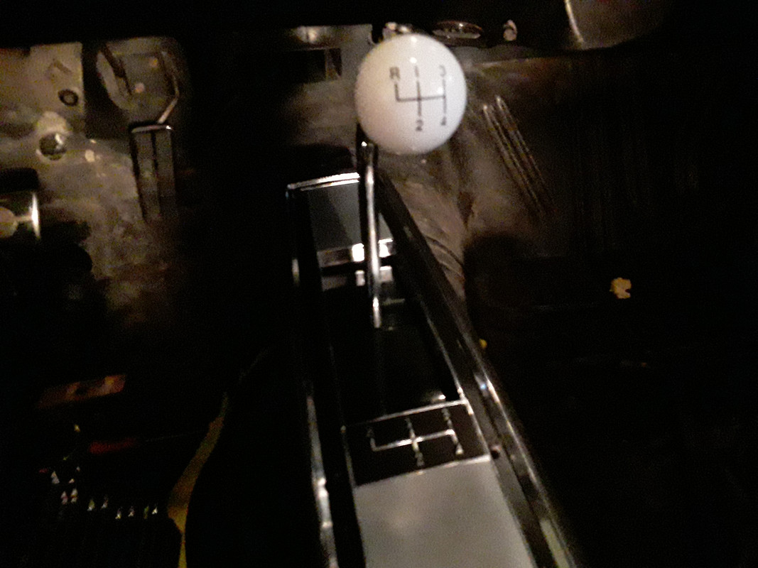

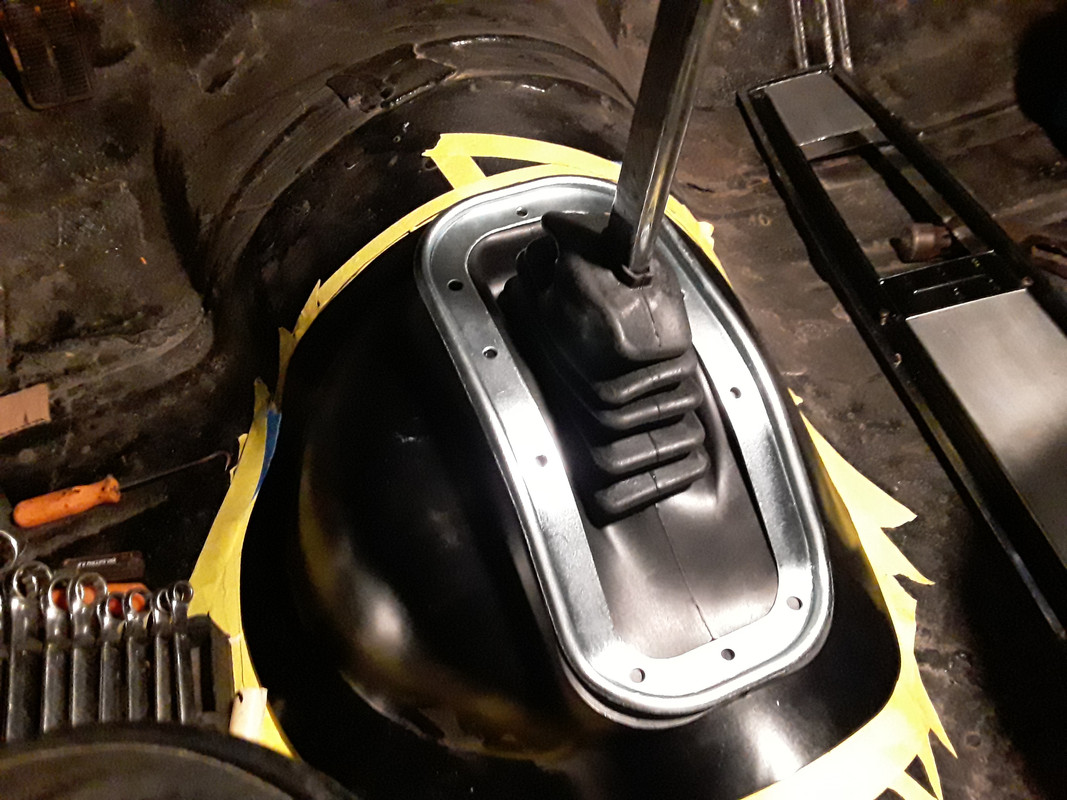

New shifter in works fine. Now finish trimming the hole for the bubble hump.

Shifter handle wasnt the original so a little modification to the shift gate it works fine.
