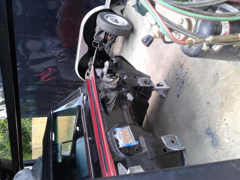

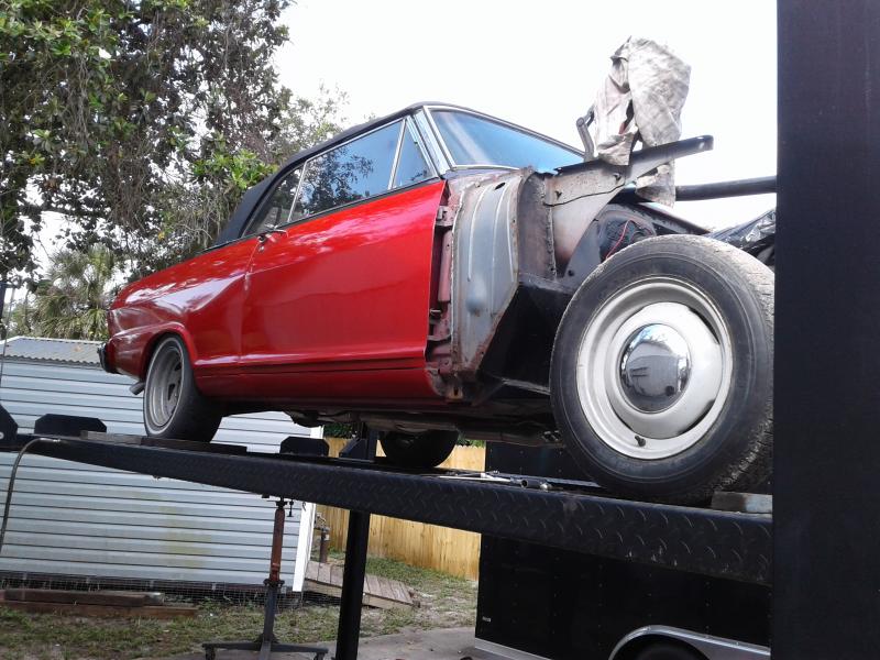

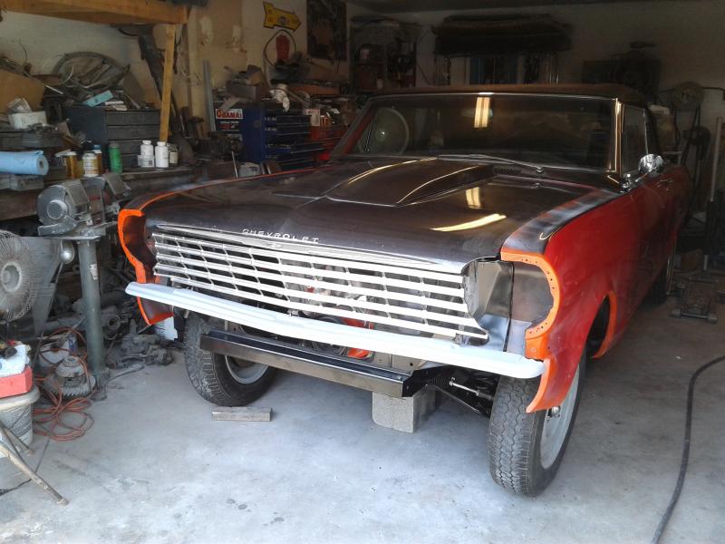

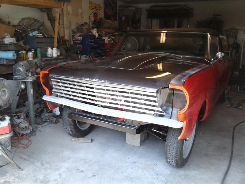

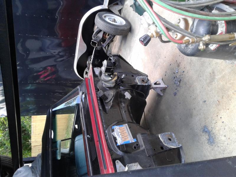

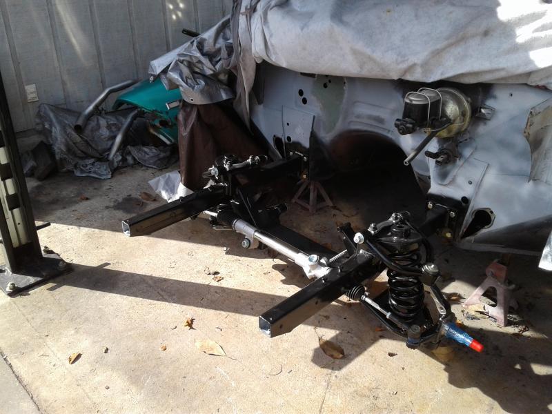

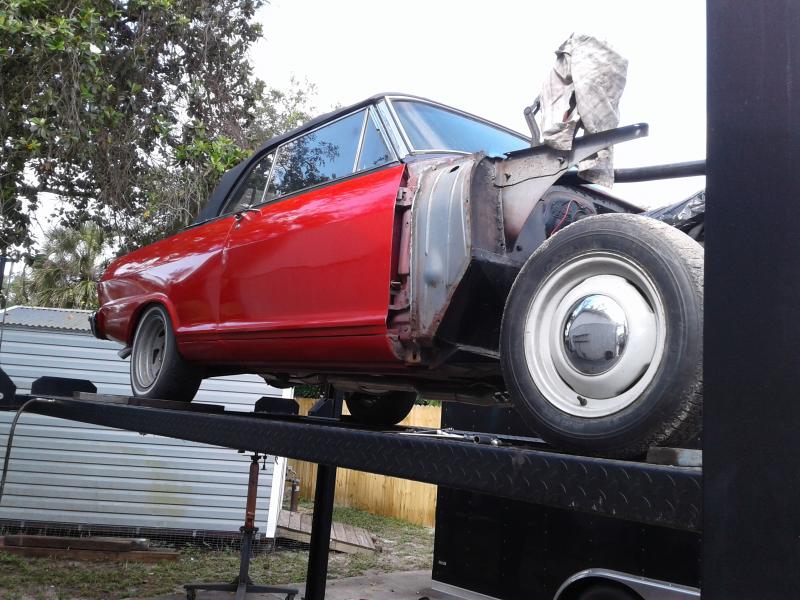

Not sure if I ever mentioned it... sometime last year my father sold his 72 LeMans Sport. He acquired a 1963 Chevy II Convertible. Solid car, just tons of shoddy work done by a bunch of hacks. Been working on that in between everything else, I am spread thin with my day job and all the other projects.
The car had some kind of cobbled g body front clip welded on. I cut that off and installed a Heidt's Mustang II front end. Been flip-flopping between engines... as of right now it is getting a low mile 5.3/60E.

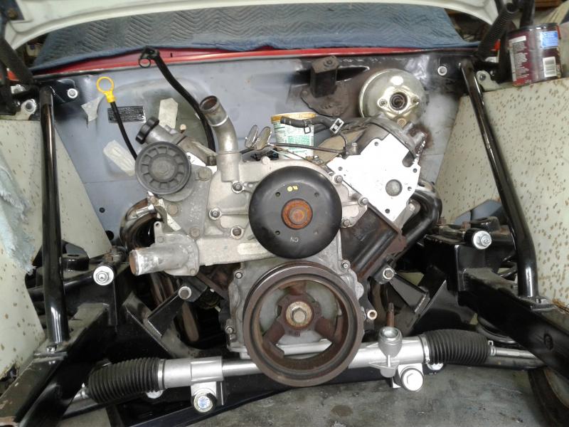

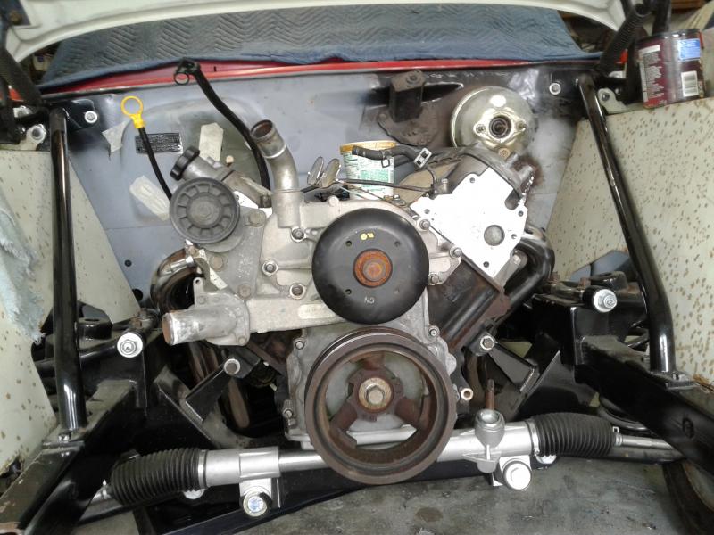

Old 10-08-2020, 06:18 PM

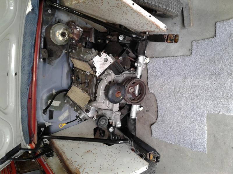

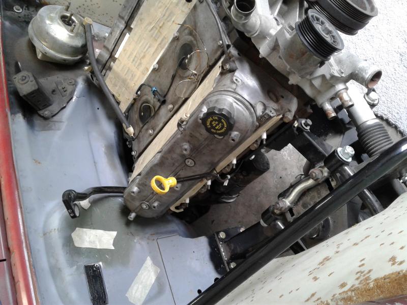

5.3L & 4L60E are in, headers should be here tomorrow. Test-fitting everything and making any needed tweaks currently.

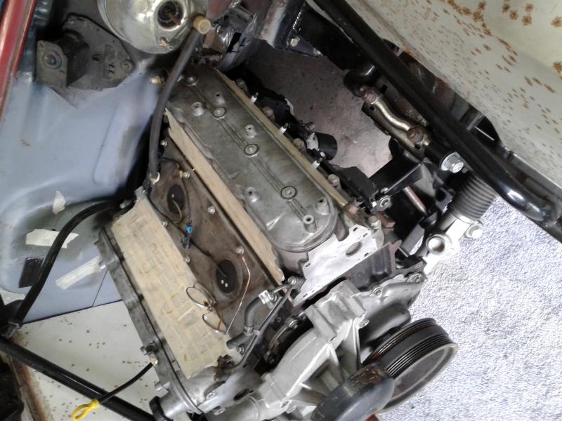

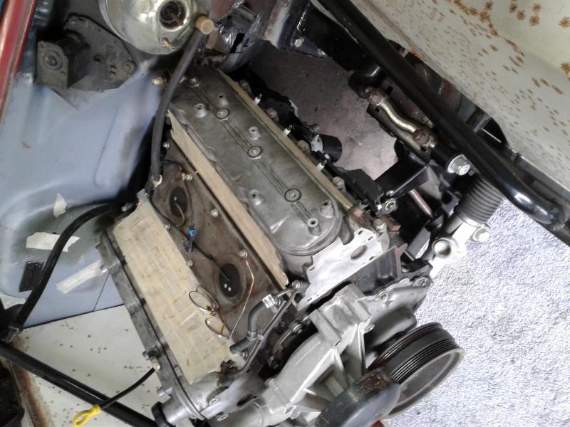

Old 10-09-2020, 05:41 PM

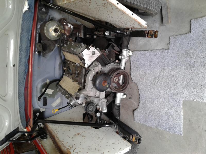

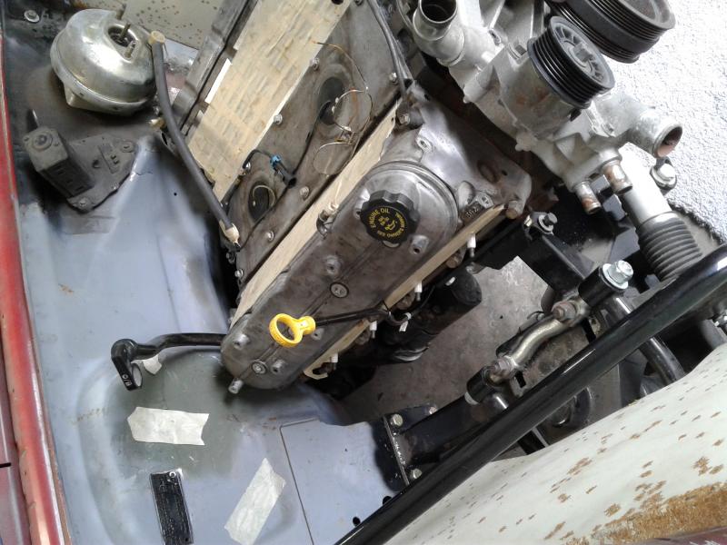

Here's more showing the real estate we have to work with. Headers delayed until Monday due to the storm.

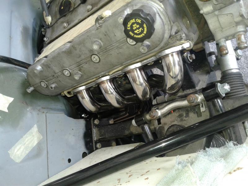

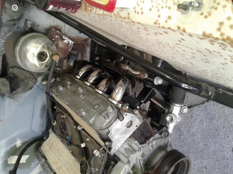

Old 10-31-2020, 03:50 PM

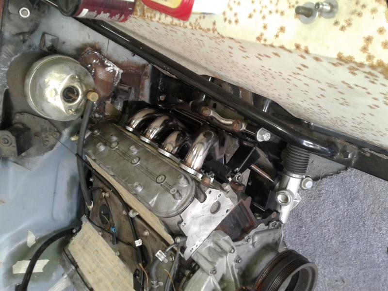

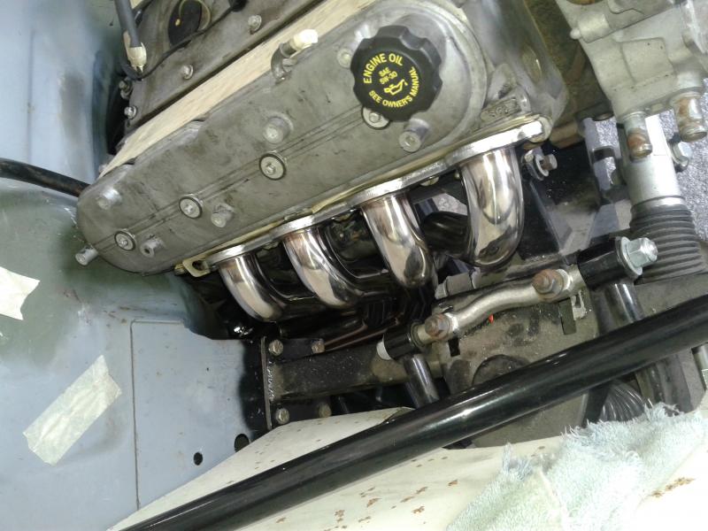

Speed Engineering 67-69 Camaro/Firebird LS swap headers are a good fit.
