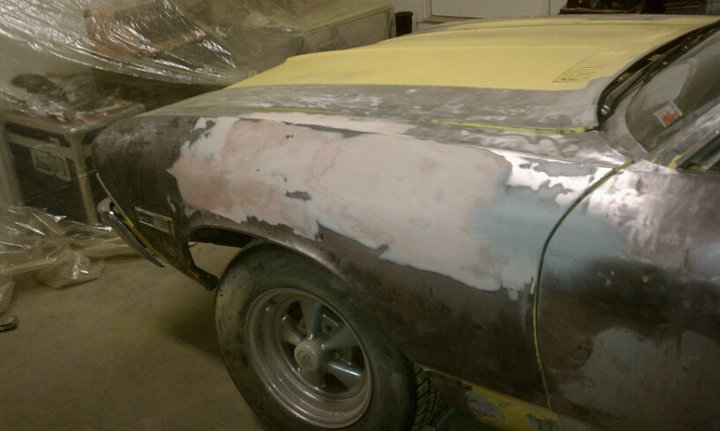

Here is my next question...I have filled in a decent size dent in my fender, I am afraid to fill anymore in fear of cracking, should I pull the fender attempt to hammer out the dent, use a dent puller (not removing fender) or add more filler. BTW...I have no clue how to remove the fender...

Pulling the fender requires removing the hood first. You could remove the inner fender which would give you access to the back side of the fender. Two bolts and large fender washers through inner fender into cowl/firewall. Bolts along the edge of the inner fender along the wheel opening. Some bolts at the rad core support. Should be able to lower inner fender and slide it out. Take the wheel off to give you some more room.
