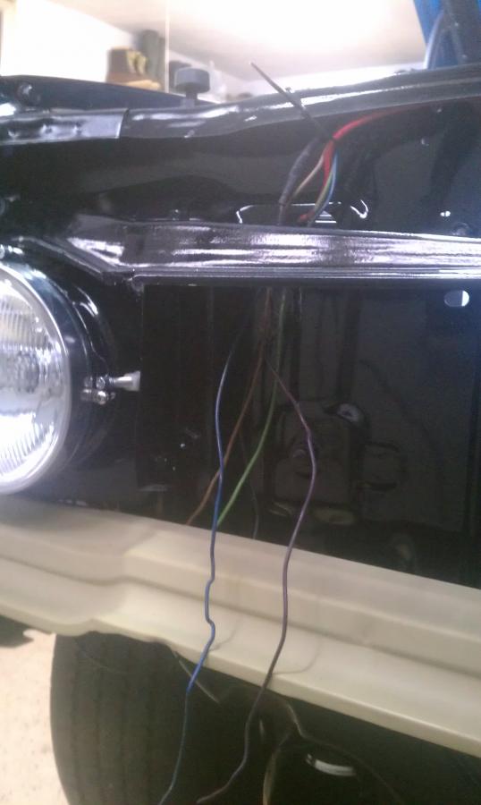

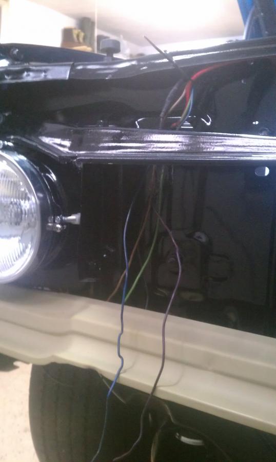

1. picture 2295 is the harness across the core support to the pass front. green and yellow are headlights, if purple is turn signal, what is the blue for?

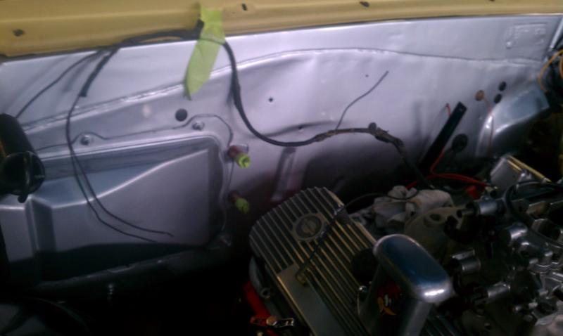

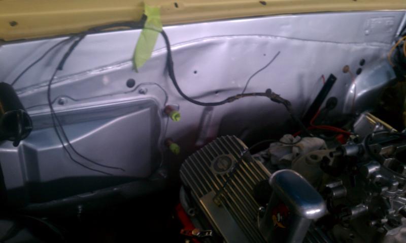

2. picture 2296 the cut brown wire on the driver side harness from the firewall.

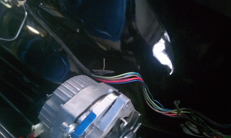

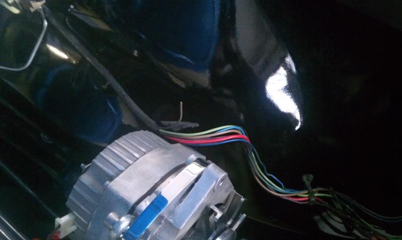

3. picture 2298 this harness is a mess.. the only one i know is the fan motor there are 3 wires im not sure of a purple, black with a purple stripe... and a blue

The blue wire goes to your parking light with along with the turn signal wire. The cut brown wire I think is for your coil. The last one, purple I think goes to you starter and a blue and black go to the wiper motor.

1. picture 2295 is the harness across the core support to the pass front. green and yellow are headlights, if purple is turn signal, what is the blue for? Both the blue and purple got to the parking light/turn signal.
2. picture 2296 the cut brown wire on the driver side harness from the firewall. Is this what is called the forward light harness, can't tell from the pic? It would run from firewall over inner fender up to horn relay, headlights etc. If so the brown wire may run to the voltage regulator.
3. picture 2298 this harness is a mess.. the only one i know is the fan motor there are 3 wires im not sure of a purple, black with a purple stripe... and a blue Purple wire may go to starter solenoid. Blue, oil pressure switch? Black with purple stripe, not sure. We are talking about engine harness, right?

do you have a diagram i could follow for wiring this properly with what i am using This may have been done already since the brown wire to the external voltage regulator has already been cut. Can you trace back the 2 wires going to the alt?
