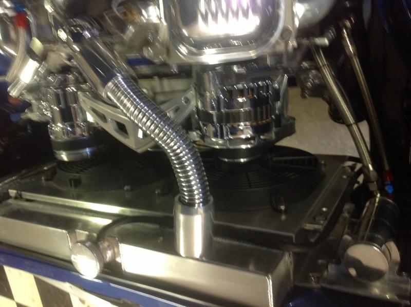

Yes it is a serpentine single belt. The water pump came in the kit. The fans are not flat against radiator. there is a flat aluminum plate that the fans mount to that holds them about 1/2in from the radiator. The fans are on thermostat control, and come on at 180deg, or when the air is on. the plate is solid there is no rubber flaps. I had those on my previous car but this one does not. The fans seem to move air across the radiator fine but nothing to brag about. I put in a new temp gauge to make sure it was correct. I might suspect it could be in the fans, being no flaps it would not allow good air flow going down the road. I sent a pic to check out and see what you think. I tried to spare no expense on my cooling system. The fans came as an assembly with the radiator....

Well that set up is certainly better than what I had in my mind. The flaps can certainly play a role going down the road but the car should be able to maintain normal operating temperatures while idling. There was a thread on Team Chevelle by Brandon from ATK Engines with a similar looking shroud and he was having very similar issues with his electric fans. I only briefly paid attention to his issues but I do remember him taking a hole saw and making holes in his shroud so air could freely flow through the shroud at highway speed. I'm not sure that was his entire issue but when the shroud is solid like that it basically creates back pressure and does not allow the air to move across the radiator like it should. You would think it would just tunnel it through the fans but that is apparently not the case....
Is your issue isolated to while driving or can you sit at idle for an extended period without overheating? I'm still not sure about your overflow at 190 issue. The only logical thing there is the cap. I would definitely put either a 180 or 160 degree stat in the car with a bypass or a small hole drilled.
