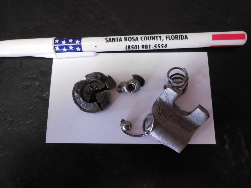

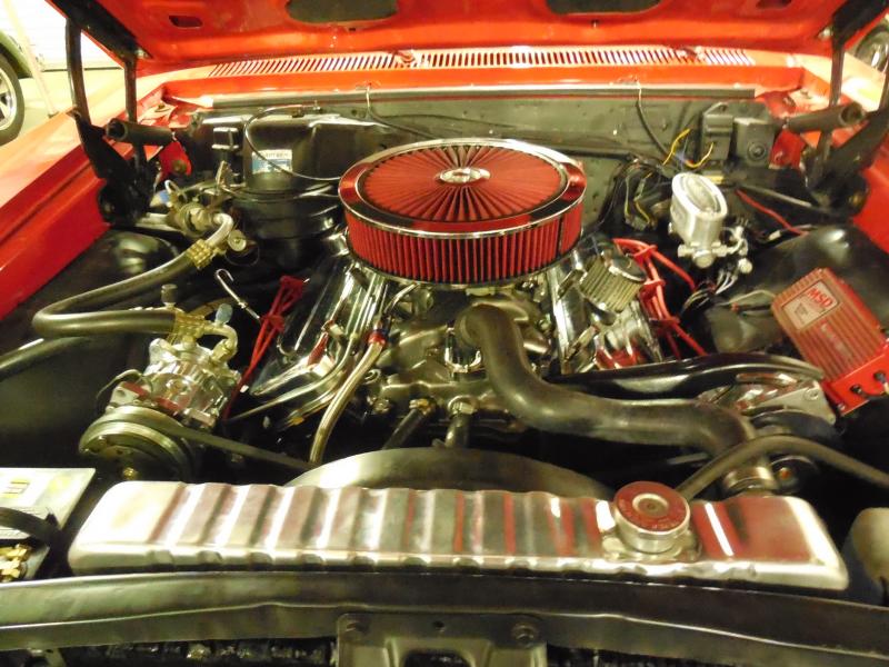

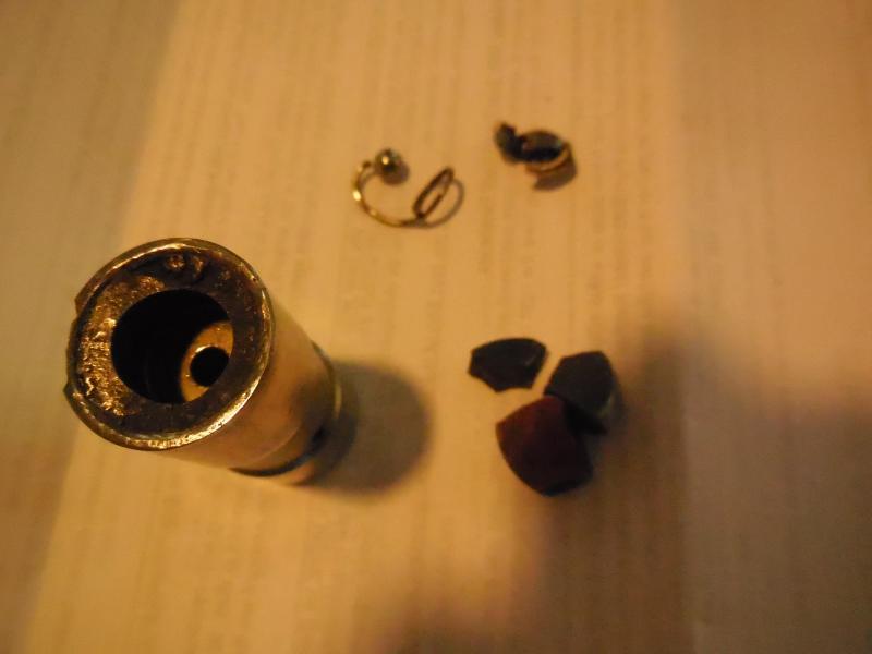

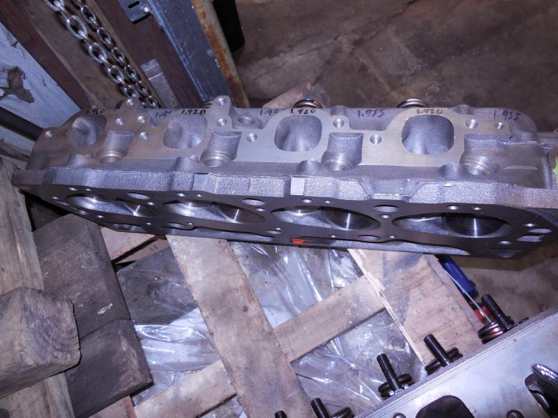

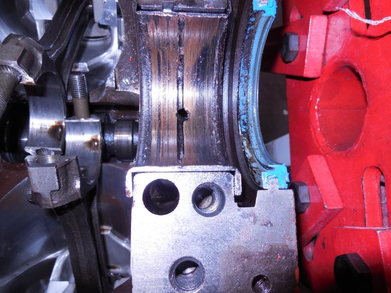

Nice 4 bolt main 427 less than 2000 miles and a lifter broke and the metal got under the rear main and let all the oil out on the highway almost spun the bearings.. Installed a 2 bolt 512 casting 427 with brand new 40 year old heads never had valves in them before. Just installed MSD fuel injection, Wow did it make a difference. 45 minutes later I blew the 700 r up. Should have got it back today but it rained all day hoping to get it back tomorrow.

bummer, last thing ya want to see is brass when you pull off those bearings!
