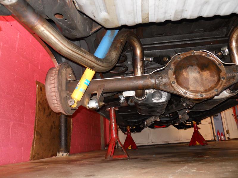

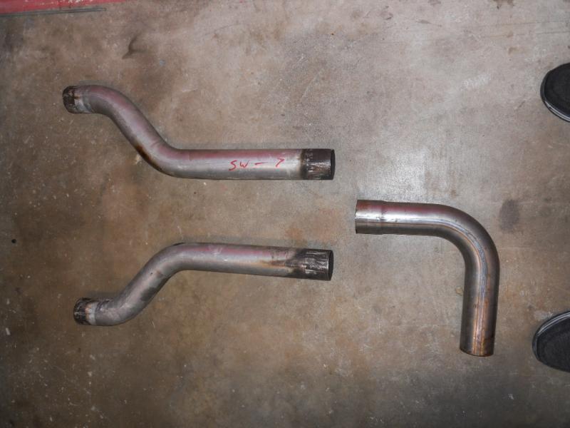

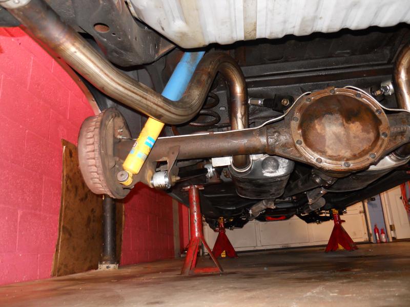

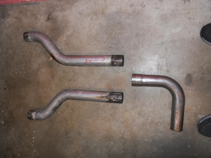

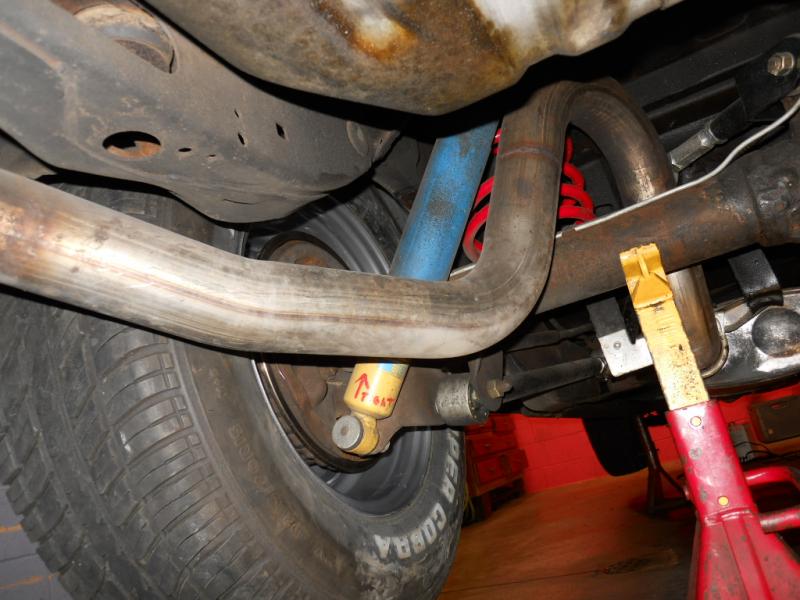

I used the Spohn Del Sphere control arms. They are adjustable and the Del Sphere Spherical bushing looks massive and should be strong..
Having a four wheel alignment along with setting the rear end up at its optimum angle is so worthwhile..
